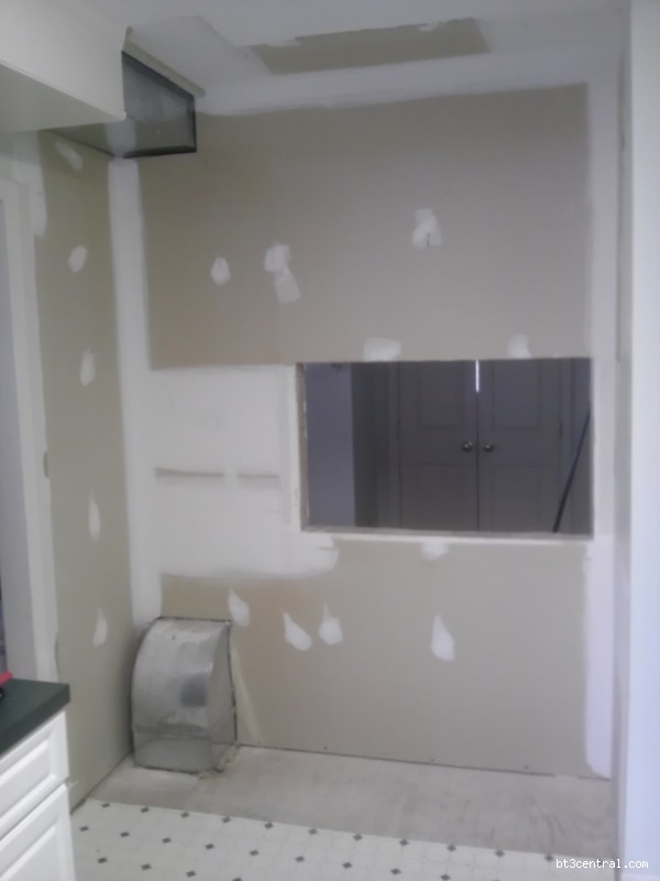

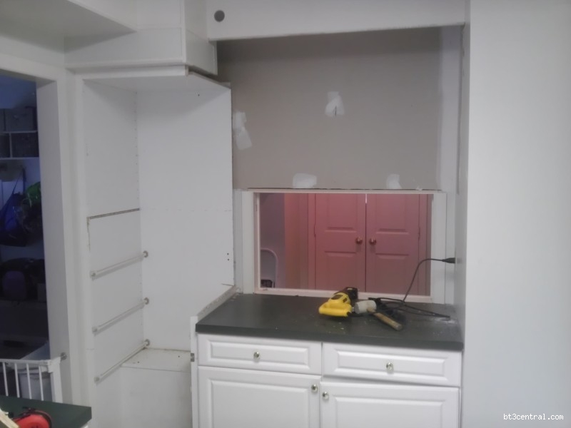

    So I started remodeling the kitchen this weekend. Why do I do this to myself?!!!
    You can see the exploratory hole I drilled in the soffit. I already removed the upper cabinet in this pic. There was always that pass through window.
    The pantry unit needed a little Sawzall surgery and the base cabinet came out without a problem. I'm kinda' regretting curbing it and not using it in the garage as a base for my lathe or sharpening center. Anyway...
    Not going to bore you with the details but after some unnecessary demo work we're relocated the fridge to the right side of this space and I'll be building a base and upper cabinet to the left and a cabinet over the fridge.
    I already moved that outlet on the right to the back left wall and I ran a new 20A dedicated circuit for the fridge. I have to move the fridge water line, too. The existing one is tapped off the main with a saddle valve and I'm going to something safer. The existing valve won't shut off--DAMHIK. The current water line just comes up through a hole drilled in the floor and connects to the fridge. Is that common practice or should I go through the bottom plate and let the line come out of some box in the wall?
    I put down some 1/4" luan where the cabinets used to be. I'm going to rip out the old vinyl and lay down vinyl plank flooring. I don't think I'm going to lay flooring where the new base cabinet will be, but will under the fridge--I will if I already have an opened package. I will lay plank under the old fridge spot, too, although a new cabinet will be installed there. I'll also lay plank under the dishwasher. Right now the dishwasher is hardwired. Anyone switch it over to a plug-in? I could add a new outlet in the sink cabinet and add a plug to the dishwasher since I have to move the DW out anyway.

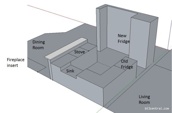

                  Paul, you have probably worked all of this out, but have you given your floor plan for the new kitchen a thorough review? I ask because you mention relocating the refridge to a new area. Most kitchens are small and everything has been tightly packed in accordingly. Just a friendly heads up, you don't want to spend all this time and find that something doesn't line up, especially because you usually find this out as your installing the last few cabinets
                  Best of luck with your project
                    Valid point.
                    I think our kitchen is on the small side. The area opposite the area I show is 9x11. Moving this fridge will give us an extra 3' of counterspace where we need it most. We have a U shaped counter that only affords us 8' of counterspace right now. It's difficult for 2 people to work in here. We thought about expanding the kitchen into either the living room or dining room, but for one reason or another it didn't pan out--mostly because I'm doing the work and won't be hiring the crew of TOH to do it.
                    The new fridge door will stick out into the existing walkway several inches because of the door thickness. We're getting one with French doors so when open, it will probably block most of that 30" walkway, but hard to tell right now without it being here. I think that's something we can learn to live with--I hope. There's currently a double swinging door in the walkway and it takes up 7" of space. We figure the new fridge door would take up an equivalent amount so we'd already be used to being squeezed down--at least that's what we're telling ourselves.

                          There is a fair amount of theory about kitchen design. Distances in the magic triangle (refrigerator-stove-sink), sizes of walkways, amount of counter space around each major appliance, amount of shelf space for storage - everything has a formula. Formulas are different for small kitchens vs large ones (Kitchen less than 150 sf is considered small).
                          I suggest that you consult with a professional kitchen designer to make a plan - it is a lot better than hoping you will get used to small walkways, etc.

                              We've gone through a few iterations on graph paper and Sketchup but it really came down to how much money do we (I) want to spend and how long are we (she) willing to wait. We also know this is not going to be our "forever" house.
                              Other than the new space in the back marked New Fridge and where I've drawn the counter for the old fridge, this is our kitchen. The walls on either side where stove and old fridge are/were are load bearing. The stove wall is a half wall that looks through to the dining room. There are cabinets above that space that hang from a suspended wall from the ceiling. I will be building cabinets on the back side of that wall on the dining room side. The old fridge wall has open shelving for plates and bowls. That is getting replaced with new uppers with glass doors from, don't kill me, IKEA. I'll be making new doors for the stove wall uppers with glass to match.
                              That big block to the right of the New Fridge contains a pantry accessible from the other side as well as the air return from the 2nd floor to the basement and air ducting from basement to kitchen register and 2nd floor.
                              Although that stove wall is load bearing (there's a post at the corner of that stove counter next to the walkway I didn't draw), we considered moving the stove wall 1-2 feet towards the dining room because there were no studs in the way. It's a large dining room (used to be the living room), but then we'd be right up against the gas fireplace insert. Insert is flush to wall; I drew the hearth. Wife wants to keep the insert although we never use it.
                              We also talked about swapping the LR for DR (how it used to be) and moving the existing LR wall into the LR space. That, too, is load bearing and there are several utilities like electric and plumbing going up that wall as well as studs which would need to replaced with probably a bigger beam, etc. The last item (beam install) I was not up for.
                              Anyway, so that's what we've got.
