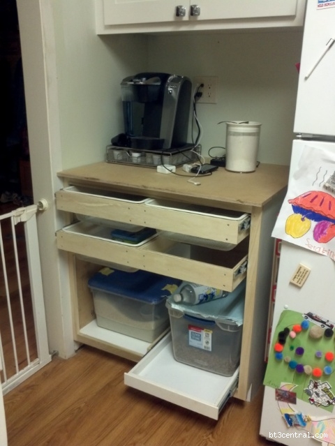

          Every time I see friends or family, they ask me "How's the kitchen?" All the uppers are done and all the lowers where shelves were being converted to pullouts have been converted except I still need to make and add the new fronts.
          This corner has been taunting me for months. I sized and made the base unit wide enough for a future, larger fridge. That was pretty much the only design constraint-and to box out that return duct.
          But then we took a trip to IKEA and my wife wanted me to incorporate hanging wire basket drawers for storing root veggies (I hate the Houzz website). Trust me, she doesn't cook with a whole lot of root veggies but there's no talking reason with her. Anyway, got the baskets and then realized making them work independently would be impossible. After a LONG time, I found a solution. The dog food and rice bins are stored down there now. I bought the drawer for the bin from the Habitat store years ago and it fit the application perfectly. So now that cabinet is waiting for new drawer fronts and doors.
          All the bases will be topped off with IKEA butcher block tops. This cabinet is deeper than normal so I decided to go custom. I've had these short 6/4 cherry boards on a shelf for 5+ years--finally found a use.
          Paul
