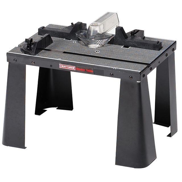

    Comment about the router table linked: The little miter gauge they supply is pictured to push the work from the wrong direction as discussed in previous posts - on a table work should be fed from right to left and this picture is dead wrong.
    I had a similar sears table at one time and its too small for anything but real small jobs. Mine actually had some 8" or so stamped sheet steel extension wings that bolted to the sides and had braces to the legs and that was totally impossible to get them all ruler flat across the top -all the edge flanges and stamped tables were too flimsy.
    The size of pieces you can cut on a router table depends not only on the length but how long it can be unsupported. Too thin and it will droop and curve at the table top and not lie flat. Too thick = too heavy and it will be impossible to route because the ends will be dragging down and wanting to lift the piece off the table. Just right and you can apply enough force and the piece be rigid enough to keep it flat across the top of the table and still control it.
    In routers all the cuts are made with respect to the table top so if your piece does not lie totally flat on the table with no gaps and no rocking when you press down anywhere, you are going to have problems with gaps where the router did not cut deeply enough and this really shows on any edge work.

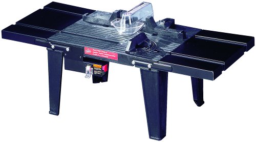

    I've seen pretty much the same table sold by Vermont American (VA) for many years, its probably VA that manufactures these for Craftsman. VA's version:
    also skil sells it too.
    Bosch owns Skil, VA, Rotozip, and Dremel currently.
    Skil's:
