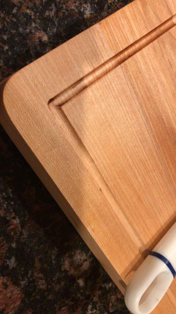

    Hello Friends,
    Just finished making this basic cutting board. I am not a pro and just a beginner as many of you know. So this may not be a big achievement. But I learnt a lot making it - especially while cutting the juice grove. Now I know how easy it is to burn maple . And the importance of making a jig for routing the juice groove in future instead of just using a straight edge.
    Thanks for all the help and advice I get here - priceless !!

    Looks good! Was the board a glue-up?
    Yeah, maple burns real easily. The more careful you are and the slower you go, the more burn you get when you slow down and take it easy. Kinda got to man up and do it with confidence and purpose! No dawdling. Throw caution to the wind.

      Thank you LCHIEN . Yeah because I was just using a straight edge and I don't have a plunge router, I would have to stop short of the end of the run and then switch off the router. That delay was enough to burn the maple. Also, because I didn't want to overshoot, I would have to clean the chips and then restart a few mm back in the groove and inch forward. That also meant more burns where I start.
      BTW, I used the recently bought and restored bench sander to sand those outer corners. As you and many other veterans here said in the advise over buying it, I now know what I was missing

        Nice job; it looks really good. Maple is as big a pain to work with as it is good looking. In addition to burning if you move to slowly, it splinters easily when edge routing if you move too quickly.
        I don't think I would have been brave enough to try to route that groove without a plunge router. My limitations are many and and I would have definitely screwed it up.

            I think it turned out very nice. The finish looks smooth and the burning isn't too bad.
            I didn't use a jig when routing juice grooves either. I used my router table and fence. I marked start and stop points on the fence and slowly lowered the board onto the spinning bit, pushed the board as far as I needed, then lifted the board off the spinning bit. I also didn't route to full depth in one pass even though the groove isn't that deep. I made a large batch of boards (walnut, softer than maple) and for any that had burn marks, I raised the bit just a tad to do a cleanup pass.
            You definitely want to practice this maneuver. I do a dry run with the bit below deck to ensure my piece doesn't hang up anywhere and that I have an idea of where I want my hands during landing and takeoff.

              Dry run is a good practice - I have encountered those situations where I would run into an obstacle or some hinderance :-( Thanks for reminding. Got to get some of these practices ingrained I guess.

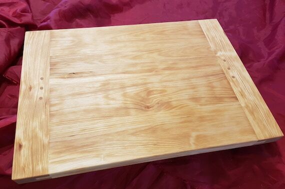

                  I guess I don't understand miters here. I googles cutting board with mitered ends and this is what it showed me.
                  But to me that looks like breadboard ends with tongue and groove breadboard ends. Pinned in the middle with dowels perhaps to allow movement.
                  I don't call tongue and groove a miter joint. Does anyone else?
                  Or show me a picture of a cutting board with miters.
                  Maybe you mean a mitered frame around a center? Not what I'd call a breadboard end.

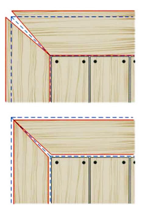

Name:	?url=https%3A%2F%2Fcdnassets.hw.net%2F0a%2Fc4%2F452e90344742ba6026071c7e0cb2%2Fmiters.jpg
                  Where the objective is to cut the juice groove with the grain all the way around?

                    Ok now I am understanding the concept with these last two sketches. Thanks Loring.
