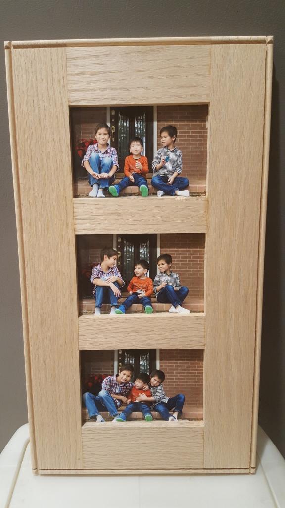

    I made a picture frame (actually two) for a triple 4"x6" pictures
    Nothing suitable in the shop, so I just picked up a piece of red oak at Lowes.
    Decided to be a little different.
    No 45-degree mitered corners. Because of the three windows I thought it easier to butt joint four cross pieces to two verticals.
    That had the interesting consequence that you don't put in a rabbet for the pictures before you join the frame, but have to put the rabbet in after the frame is assembled. Then you get rounded corners. At first I was going to use my universal rabbeting bit with 8 bearings but then I realized the dia. of the main cutter was 1.375" which would leave a huge radius corner. I finally ordered a flush cut bit of 3/4" diameter and a 3/8" bearing (very small) to make 3/16" rabbets which was what I designed for but failed to look and see that I actually had a rabbet bit combo that fit, Anyway I had to use my trusty old HF corner chisel to square up the inside 3/8" radius corners.

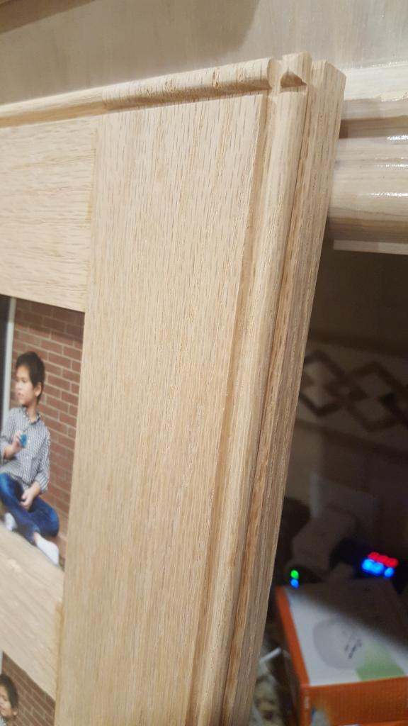

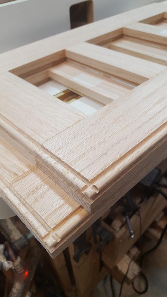

    Another new thing I tried is using an edge beading bit. This I feel is an underrated bit with an interesting profile. It does require two passes on two sides of an edge - one with the workpiece flat and another with it on edge, but it gives a cool profile on vertical edges of things. A bit 3-D with depth because of the cut on two sides.
    In this case I did them both directions so you get a little square thingey where it crosses.

    I'm thinking of routing a very small 45-degree chamfer on the inside of the three windows. to soften it a little. The resulting corners would be slightly rounded.

    Very nicely done! If you do rout the chamfers, they should be easy to "square" up with paring chisel since all of the cuts would be with the grain.

    Nicely executed! Unique look.

    Looks good Loring. Funny how the corner detail looks better from afar, to me it looks more pointed. How are you going to finish it?
      LCHIEN commented
      thanks. Wipe on tung oil compound

    They are really quite nice, and I love the corner detail.
    Although I think the framing of the pictures is very excellent, I do agree with your thinking of adding a chamfer would be an enhancement and perhaps lessen the shadow that is cast on the pictures.

    You did and excellent job with routing. It is not hard to knock one of those corner accents with a router, but you got all four perfect. And I like the looks of them too!
    Edit: It is not hard to make those router cuts WITH the grain, but when it is cross grain, I run into trouble with small chunks taken out.

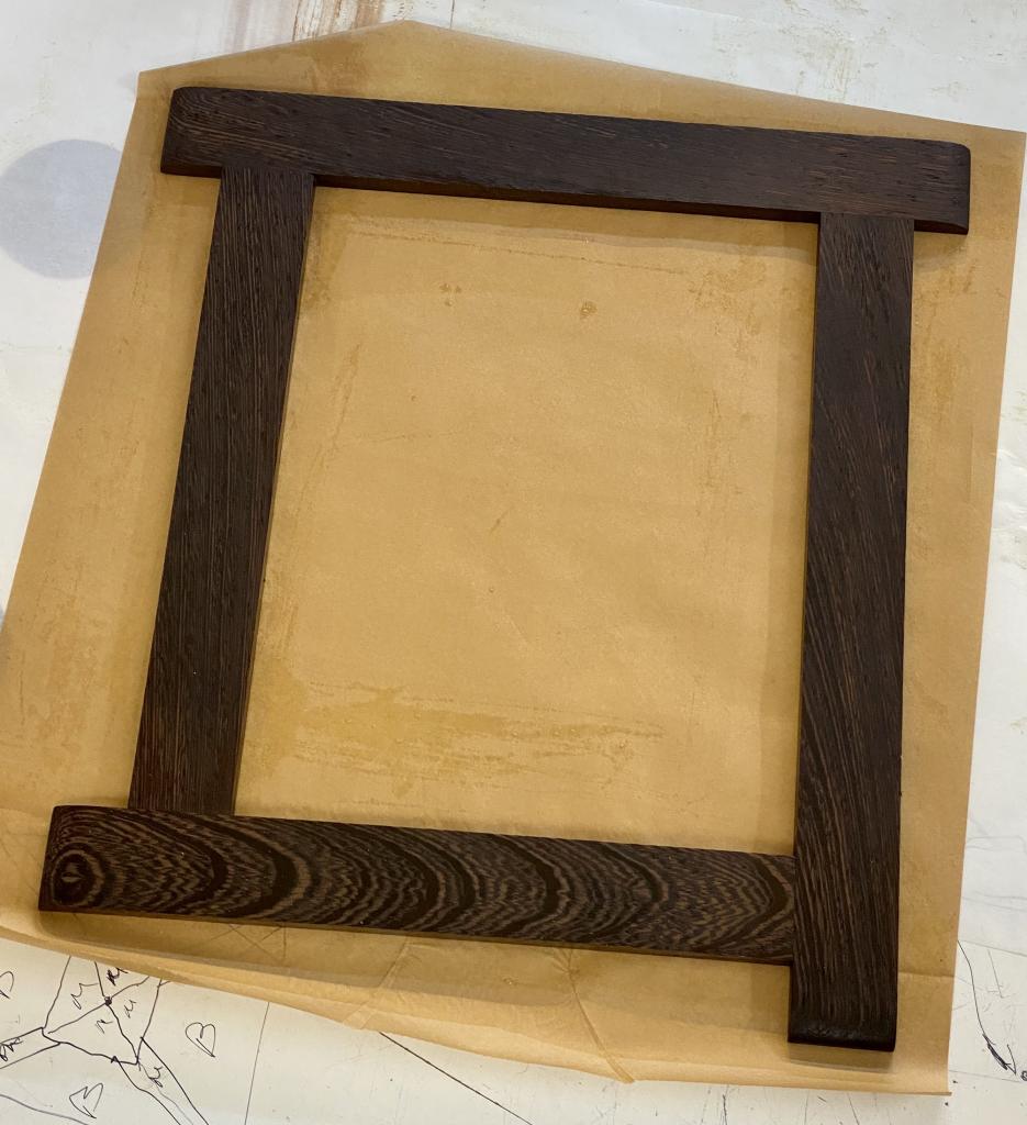

        I made a weird one yesterday also. Oil is drying now, hoping to spray tonight and install the picture tomorrow.
