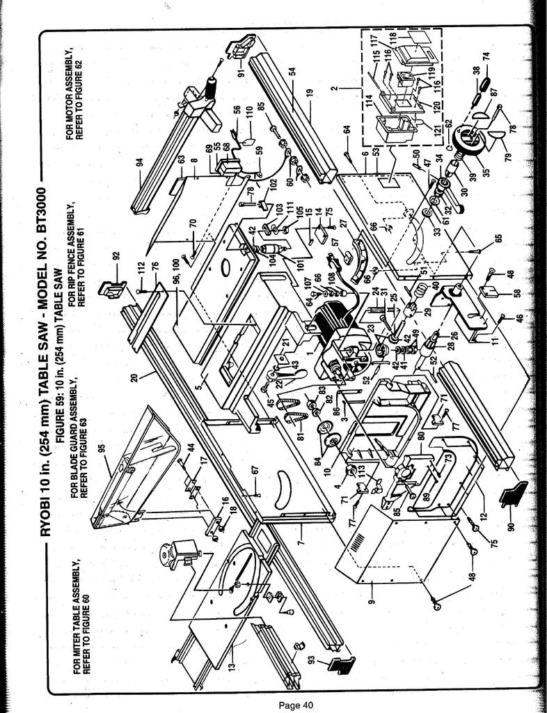

      here are two hi-res scans from the BT3000 manual for exploded diagram and parts list, if that helps.
      Maybe 2 screws, 85, hold the guide holder 80 to the motor 1 as shown.
