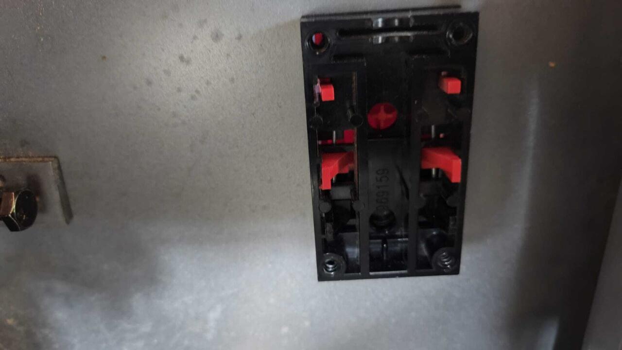

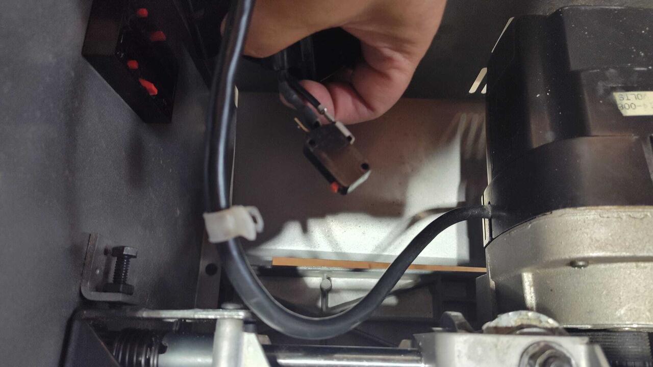

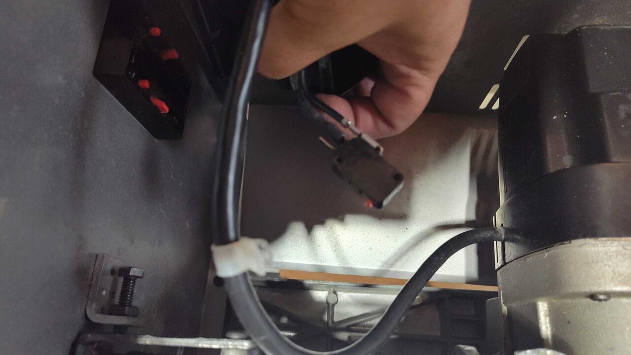

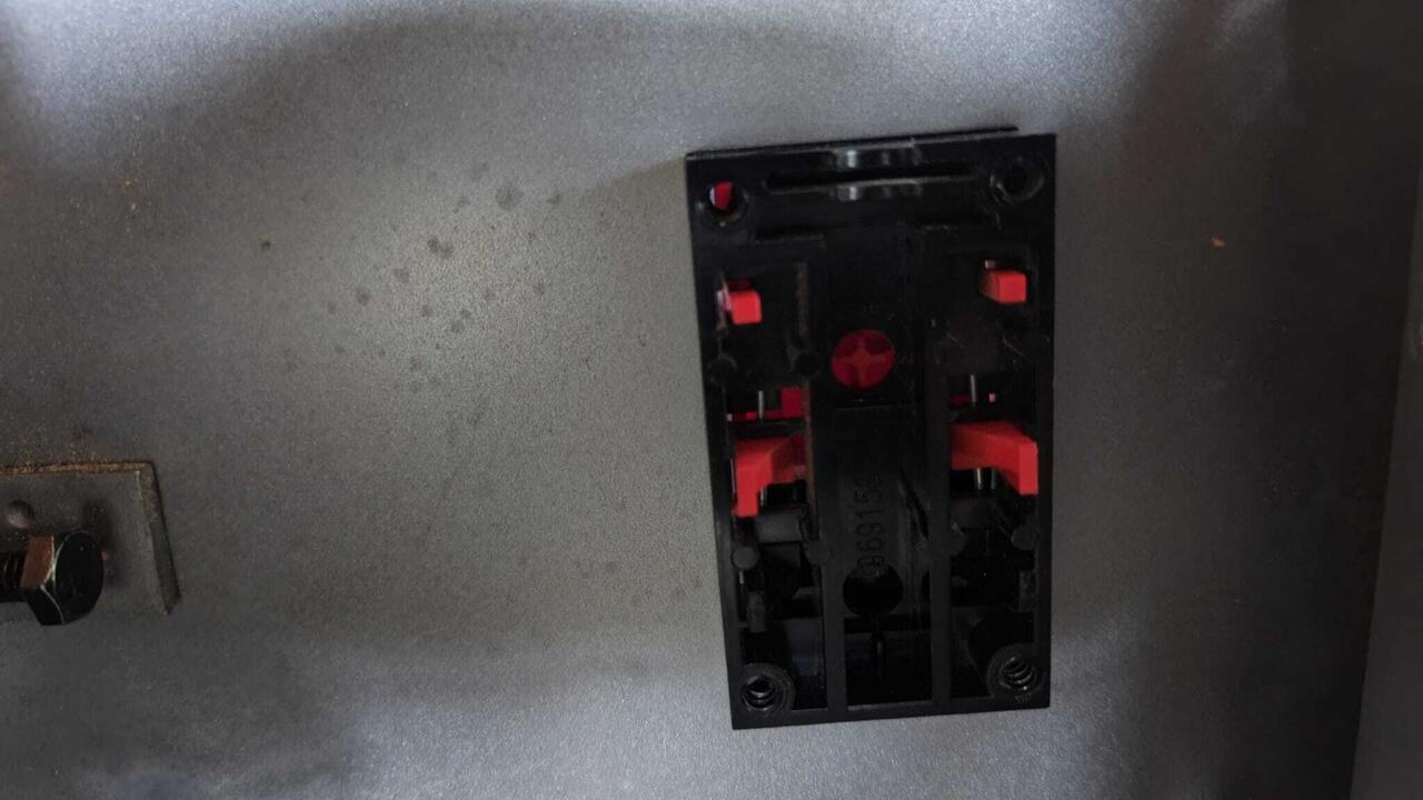

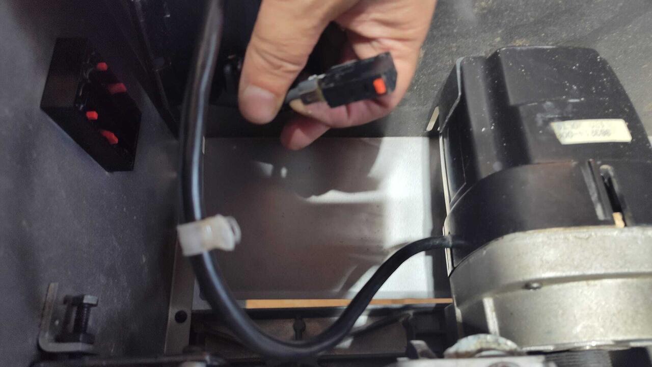

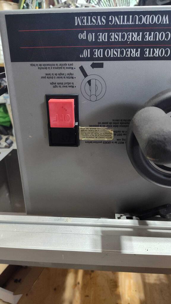

    Hello, I'm a newbie and recently bought a used BT3000. I ended up having to disassemble it to replace the belts and shims to get it to raise and lower the blade. While doing so, I took apart the power assembly to get better access to the motor and, stupidly, didn't take pictures. So now I am attempting to reassemble the power related parts to be able to turn the saw on and off with the on and off buttons, etc. FYI, I can turn the motor on and off directly by plugging the machine into a wall outlet. I have some pictures of parts that I have attached that I cannot figure out how they connect.
    The Part in 448882109_10161523581559350_8307068740688540592_n. jpg, 448737608_10161523581844350_7186069899323442116_n. jpg, and 448882471_10161523581764350_8031220182349627099_n. jpg that I am holding in my hand probably connects to the back of the on-off switch in 448774968_10161523581699350_1125413308973126046_n. jpg and 448846969_10161523581464350_2649981712900427115_n. jpg which are the back of the on-off switch. Any info, pictures, etc. that people here can provide is much appreciated and thank you in advance.

      Where's the rest of it? The switch looks to be a momentary switch with the plastic parts operating and canceling the switch. I will look to see if I still have that switch, but as Loring points out, those were recalled. I received one of the last free replacements, and I'm thinking a lot about replacing that with one more accessible. As it is now, I have to reach under the overhang and fumble the switch blind, as you would have to do if that switch were operational. I'm thinking to replace the original with a plug-n-play switch like these:

        As I mentioned it looks like you have the original switch from the front, altho its hard to tell from your front panel photo which is dark. The original switch had two buttons one red (off) and one green (on) when you pushed on the other popped out.

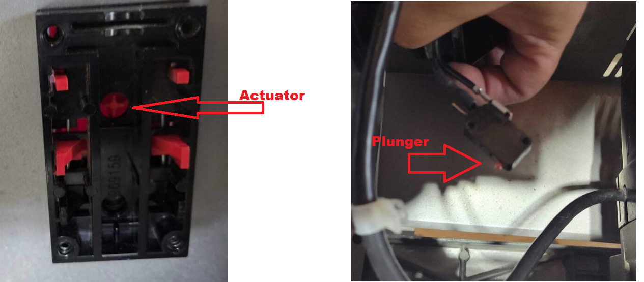

        From your pics It appears to me that the switch comes into two parts, a front assy with the two buttons stuck to your saws front panel and a "microswitch" assembly that snaps on the back (or else you broke it) The red button on the back part is the plunger, pushed by the actuator button to turn on the switch. This is totally guessing but the back part looks like it might snap into the front part and be retained. Probably only two possible orientations. All the wires are already connected to the back part of the switch.
        Maybe there's a back cover for the assembly that holds the microswitch in place and protects against shorts? I see four mounting holes threaded in the corners of the front piece

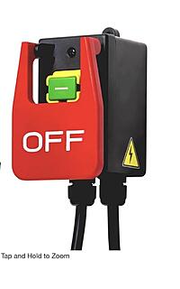

          Wouldn't it be possible, and a better idea to simply swap this switch out for one of the newer style safety switches anyway?

          I agree with DB, just replace it with something like this and move on. It’s much easier to locate to stop the saw, and will likely last 100 times longer than the junk it came with. Click image for larger version

            Sorry LCHIEN not the switch I was talking about. capncarl got it though... I guess I wasn't clear enough... My saw came with a spare switch, which is getting funky now and I will likely go with one of these heavier duty paddle swtiches as a replacement.
