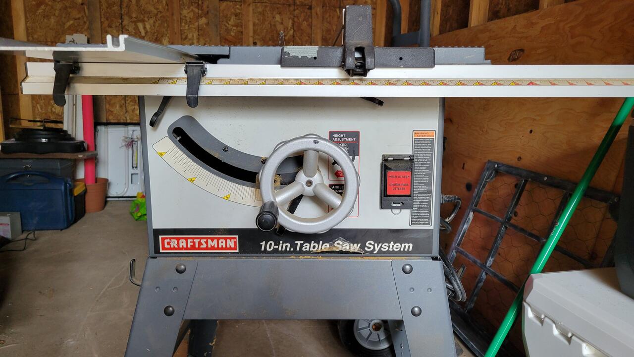

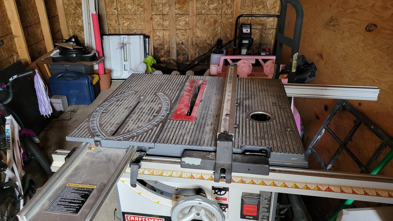

    Took me a while to find you guys. But, I'm thankful I did. Yesterday I picked up a 22811 at a garage sale for $50. Was told the fence was broke and was missing some parts. They really didn't know, since they got it from their deceased parent. The saw turned on and I didn't appear like the fence was broke at all. The handle was broke and the opposite side wasn't attached properly, which I figured out when I got home. There is some damage on the fence where it looks like the blade hit it.
    I was wondering if there's anything I should do prior to cutting on this? Seems like everything is square, blade to rip fence. I plan on giving it a nice cleaning as well.
    It is missing the miter gauge and assembly. The fence locking handle ( I just used a wrench to loosen and tighten it ). Wrenches for blade changes, and router mounting assembly.
    Any advice on parts, maintenance, and operation would be much appreciated. I have been going through the FAQ and some great info is in there.
    Thanks in advance.

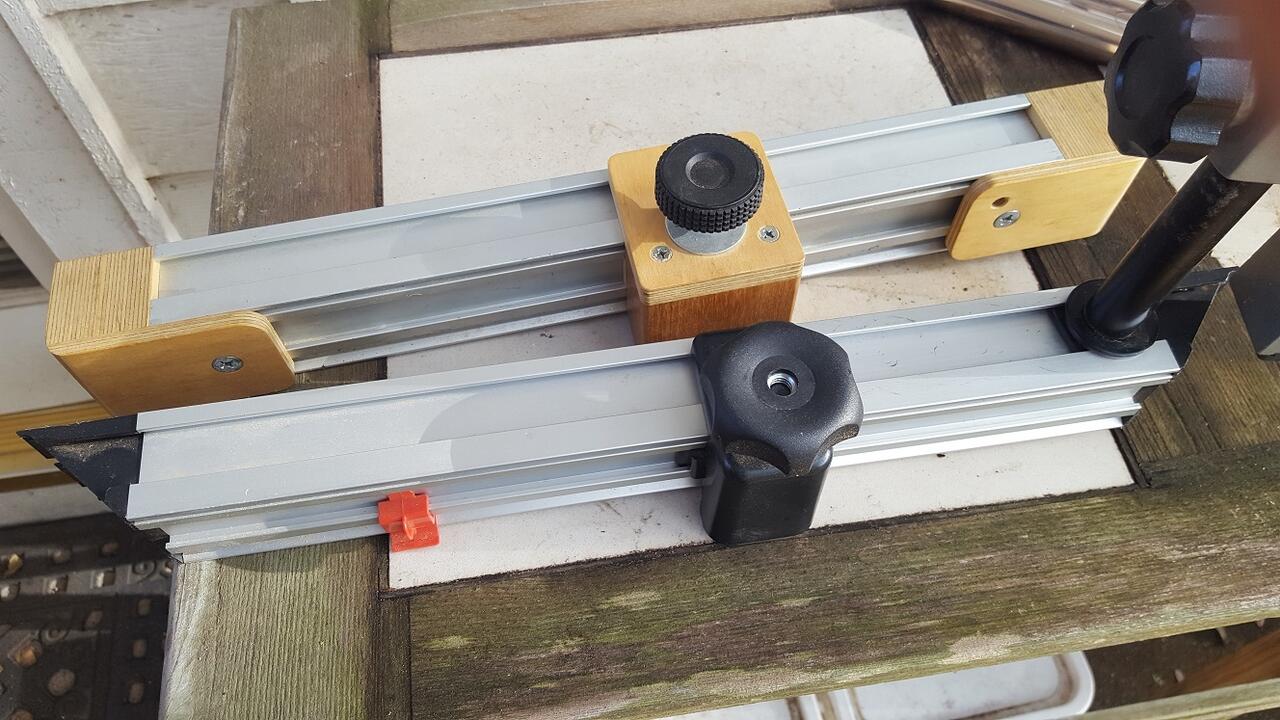

    People have made replacement brackets from wood- not that hard. see collage of photos farther down. My wood one (top) and OEM one, bottom: Click image for larger version  Name:	20200103_094734sm.jpg Views:	0 Size:	142.5 KB ID:	858789
    Make sure it has the fence extrusion, the orange angle pointer indicator, the black pivot on the bottom and fence holder bracket. The bolt that goes through the slot in the SMT, the holder is just a 5/16-18 hex head bolt and the knob is an off the shelf female open though star knob most hardware stores will have. The plastic end caps are not necessary.

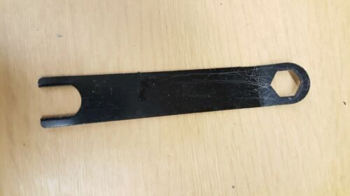

                FOr the blade wrenches, you really need the back end of either one the BT3000 supplied wrenches - to lock the arbor while you use a hex wrench to turn the arbor nut. The arbor nut is a 3/4" SAE wrench, any box end or combination wrench works, I like the ones with a slight offset to keep your fingers away from the blade tips. The second wrench is 1/2" SAE hex wrench, again any box end or combination wrench will work to loosen the nuts that hold the blade guard/riving knife.
                However the arbor lock portion is the hard one to duplicate. I don't know what fits or works for that job other than the OEM wrenches.
                I only use my original wrenches for the arbor lock. I keep a pair of combination wrenches from the Pawn shop ($1-2 each) in the right size hanging from my saw, handy. More comfortable and a little longer lever.
                Don't forget the arbor nut and arbor are left hand thread (it causes the nut to tighten when the blade turns rather than get looser). That gets everyone sooner or later. Makes no difference in the wrench, just which way you turn them.
