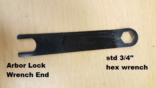

        Let me reword my last post
        Click image for larger version  Name:	BT3 Wrench.png Views:	0 Size:	108.7 KB ID:	844657
        This is one of two wrenches that comes with the saw. One end comes with the arbor lock wrench
        The other end comes with a 1/2" closed end hex wrench or a 3/4" closed end hex wrench.
        The only real reason you need one of these is for the arbor lock function. The closed end hex wrenches can be satisfied by any open end or closed end offset box wrench or combination wrench you may already have or can get one to dedicate to the saw from a pawn shop for a couple of bucks apiece, Or, get a brand new HF SAE set for $8 less discount and take the wrenches you need.
        The arbor lock is somewhat special, I have not found a substitute for it. The width of the wrench opening is .75" and the width of the wrench is just under 1.25" and the thickness is .145"
        The arbor lock slips in the small cutout to the right of the throat plate opening and matches a pair of flats on the arbor to lock the arbor from turning as you remove the arbor nut - much safer than trying to grab a hold of the blade with its sharp teeth in a safe manner.
        The outer width and the thickness is just right to fit and work smoothly.
        Not a complex thing and probably easy to fashion out of a piece of thin sheet steel. The resulting thin prongs are probably too easily bent if made out of aluminum.
        My last warnings is that the arbor nut is left hand thread so it turns opposite normal nuts when you go to take it off.
        And that a standard wrench will be quite a bit longer than the supplied wrench. Normally the arbor not should NOT be overly tight so be careful because you can get a lot more torque with a longer wrench. The saw direction results in self tightening (that's why its left handed, so it won't unscrew when run) and so you really need to make the nut finger tight and then just finish with the wrench another 1/8th turn or so with the wrench.
        Overtightening will result in warping the blade (especially with thin kerf blades) and does no real benefit. Don't overtighten!

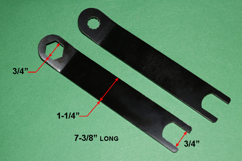

          • 2811
          Here is a picture of the wrenches that came with my BT3100-1 which I purchased on clearance in 2005.
          Except for locking the arbor in place with the open end of the wrench, I prefer to use an automotive-type open-end box wrench to remove the arbor nut. It grips the nut better (broader surface than the OEM wrench) and thus has less tendency to mar the nut. I purchased a separate automotive type wrench just to keep with the saw. Harbor Freight has a good selection for a low price.
          Loring has provided a great description of the concerns.
          Click image for larger version  Name:	IMG_2164RE.jpg Views:	0 Size:	480.8 KB ID:	844660
          Hope this helps,
