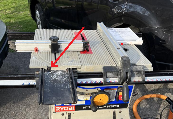

    New to me BT3100
    I’ve been looking into picking up a used table saw for a bit, mostly since I’m just getting into woodworking and home DIY projects, figured a table saw would be a good compliment to my sliding miter and circular. Most of them seemed similar, saw this one that peaked my interest as it seemed more solid and it was nice to find this forum dedicated to it! So I’m going to give the manual a look over and try to figure it out more this weekend, I noticed the miter table doesn’t slide….is there a lock or something I have to click to get it to move? The guy said he wasn’t sure what he did with the blade guard and from what I see online, the riving knife is attached to that for this saw, so I figure I want to find a replacement for that, since the riving knife would help me feel better/safer as I learn working with the table saw. Also any obvious pieces that I’m missing? What should I use to scrub down the surface, it’s got some buildup on it from sitting in the guys garage, anything better to use or to avoid for cleaning? Also any obvious pieces that I’m missing?

    There is a lock on the smt. It’s a little black tab on the near side in the center of the table. Shark guard makes a riiving knife but I can’t seem to find the right one yet.my used and abused BT3000 didn’t come with one so I made a zero clearance blade insert with a splitter for now.

      Yeah its right here where the arrow points. It has a little little finger lift to raise it from locking into the SMT tray base. If its stiff, you can lube it and loosen the screw holding the black lock.
      Watch out, you have the Miter fence set up so far to the right you risk cutting off the end.
      Welcome to the forum, enjoy your new saw, download the BT3 FAQ which is linked in my signature line here at the bottom of my post.
