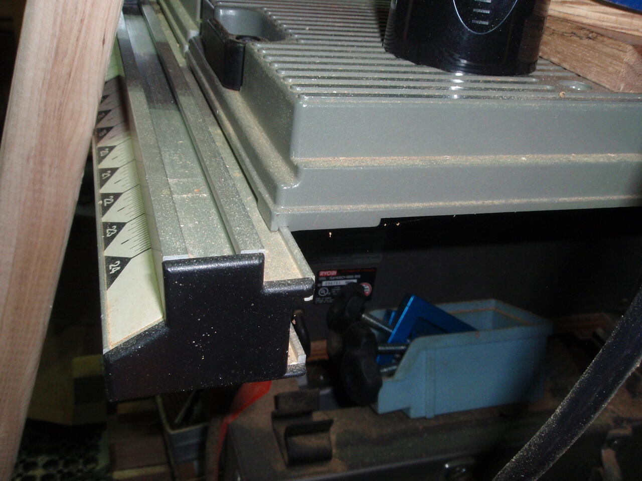

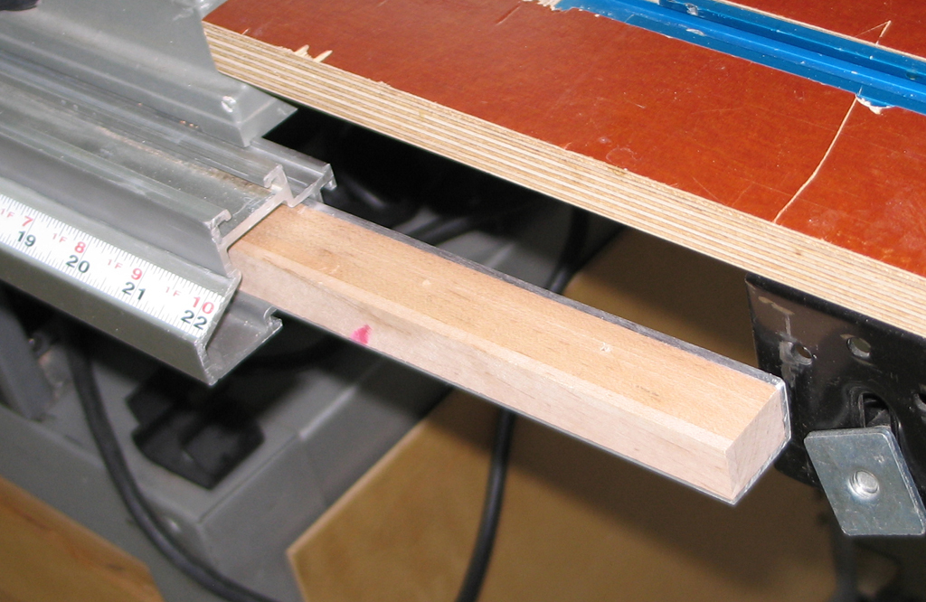

          Originally posted by sloboataz
          The rails are level with the main table
          This does not make sense to me. The top of the front rail should be about 1 inch below the work surface of the saw. Look at the profile of the front rail: one side is significantly larger than the other sides; the rail mounts with this large side on the bottom, parallel to the floor. The angled/beveled surface should face upwards and forwards - facing your eyeballs as this is where the inch measurement stick-on tape is supposed to be. The rear/back rail is more-or-less rectangular in shape and mounts with the long axis of the rectangle against the back face of the saw.

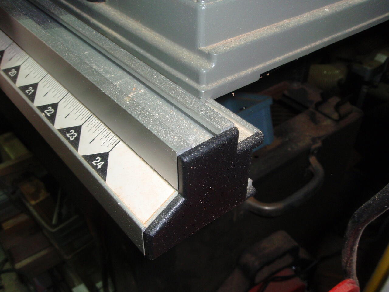

          The first attached picture is the front rail mounted to my saw. You can just make out the accessory table front/right corner sitting on it, next to the plywood work surface I added to my saw. The pic was created to show my wood+aluminum "L" bracket bits that screws inside the rail to support a rail extension... so ignore that stick of wood for now. And the plywood piece is out-of-position in this picture; it is normally flush to the accessory table rather than sitting on it... it's out of position in this picture because the extension rail was removed to show that wood+aluminum "L" bracket for a different post on this site.
          Click image for larger version  Name:	Home_Made_Rail_Insert_2465.jpg Views:	0 Size:	485.5 KB ID:	846407

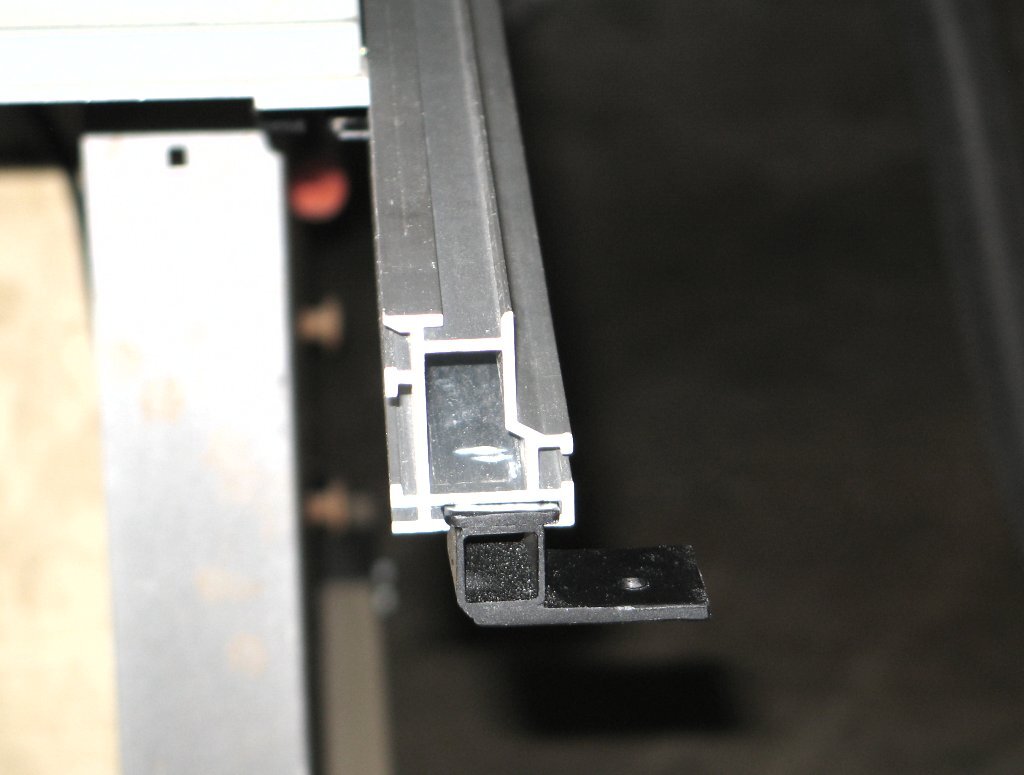

          This picture shows the end profile of the rear rail; the body of the saw is on the left side of the picture. Ignore the black metal piece on the underside of the rail... that's a support bracket for an add-on thing on my BT3.
          Do note however the foot tabs on the back/bottom edge of the accessory table: they slip into the upper groove of the rear rail; the accessory table is the overexposed thing at the very top/left corner of the picture.
          Click image for larger version  Name:	Accessory_Bracket_Installed_1440.jpg Views:	0 Size:	64.8 KB ID:	846408

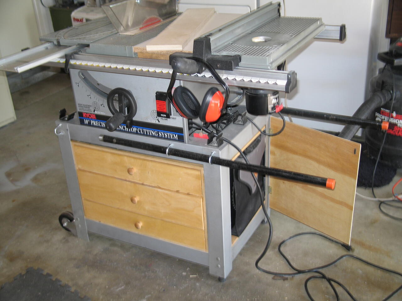

          This is an older picture of my BT3000, before I extended the rails as in the prior pics. You can see how the front and rear rails are oriented and that there is an inch or so between the top of the front rail and the work surface of the saw. The SMT is on the far left (without the miter fence), the accessory table is on the far right with a shop-made melamine spacer between the accessory table and main saw table in this pic. And my customized base. BT3's had several different bases over the years; the early ones had side panels with a large opening as in this pic; later models had side panels with only a mail slot opening... so my tall but shallow side storage compartments would be impossible on the later stands. BT3100s came with "splayed leg" stands, not box shaped ones like the one in my pic. The black pipes are handles for moving the saw around - wheelbarrow style; an idea originated by another sawdustzone.org member. The slide left, into the open "U" bolt, for storage.
          Click image for larger version  Name:	Basic_saw_0129.jpg Views:	0 Size:	133.7 KB ID:	846409

            First of all, when I suggested shimming the table I was thinking about the SMT - sliding miter table. As MPC described.
            Lets make sure we are talking about the same thing:
            The auxiliary table is the one with the hole for mounting the router if desired, or just used as a support. Is that what you are talking about when you say accessory table?
            Next you say the rail is level with the main table. Do you mean parallel? Because it is not level with the main table but sits below by about an inch as MPC said.

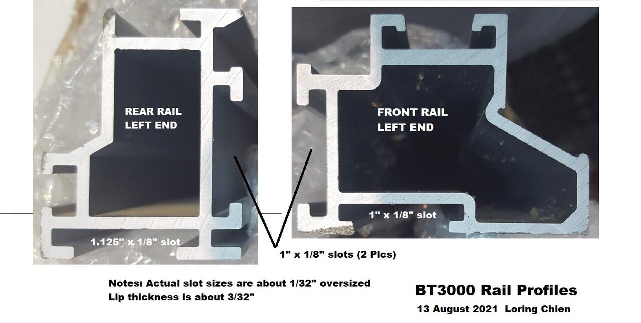

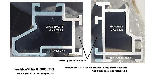

            People have had problems with rail height - there are 8 ways to attach the rails to the saw body and only one is correct... all combinations of front to back and one or the other side upside down swapping L&R and F to B.. Are you 100% sure the rails are on correctly? As shown below.
            Click image for larger version  Name:	BT3000 Front and rear rail Profiles.jpg Views:	0 Size:	75.8 KB ID:	846411
            or as viewed from the right:
            Click image for larger version  Name:	reversed rail view.png Views:	0 Size:	170.1 KB ID:	846412

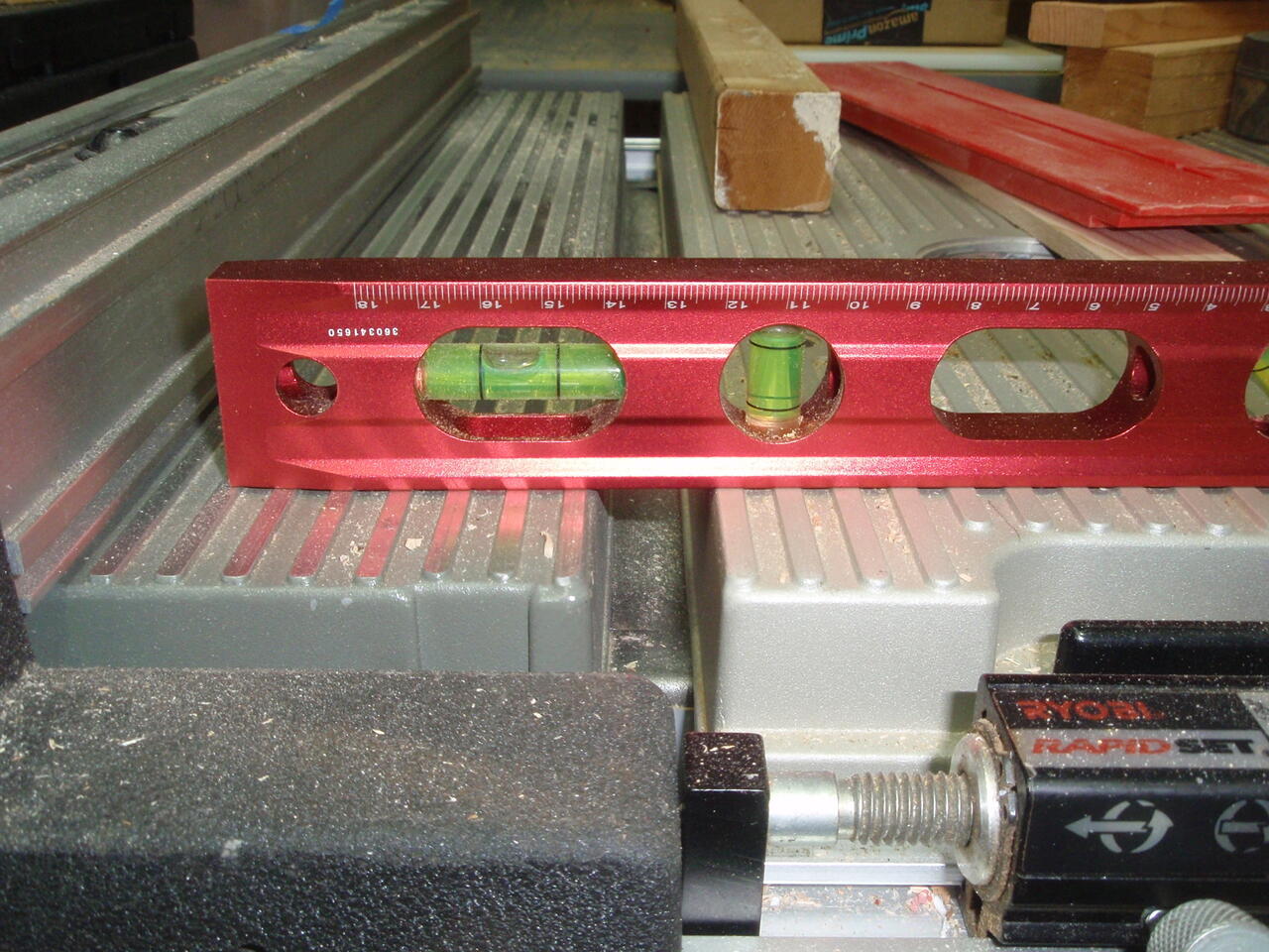

            If the rail mounts to the saw body and the Aux table literally sits on the rail and is very much constrained to the right height. Even between BT3000 and BT3100.
ID:	846413 Click image for larger version
ID:	846414 Click image for larger version

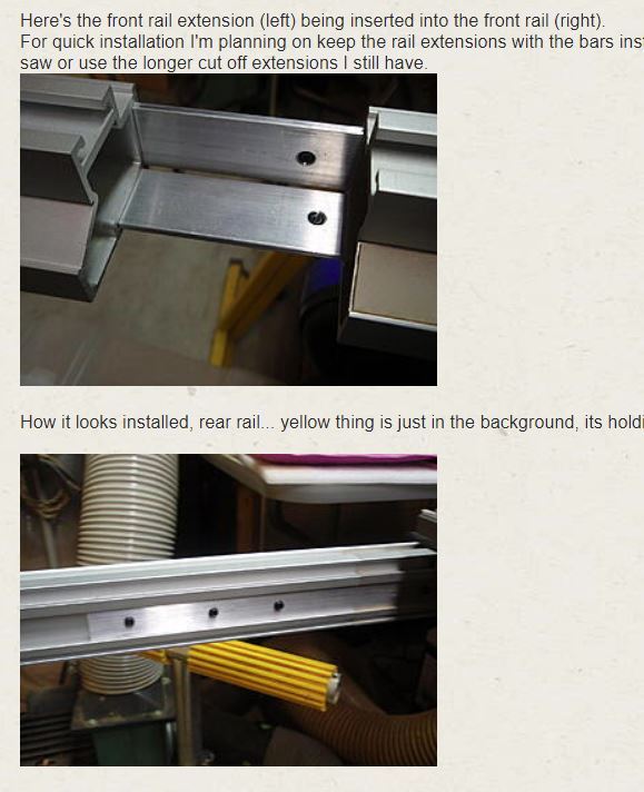

                      if you ever need to you can make those small aluminum plates that the rails mount on quite easily.
                      I bought some 1/8th" thick aluminum bar that was 1" (quite common)
                      You can cut the 1" into multiple pieces 1-1/8" wide and then drill and tap (easy operation in aluminum, tools cheap) Even cutting aluminum is easy, I use my woodworking blades on a miter saw. But theoretically a table saw and miter fence will do an equally good job. Aluminum is a soft metal and machines easily with woodworking tools. But you can also use a hacksaw and file for fine adjustment if you are squeamish about using your wood tools on it.
                      cut into uncritcally long pieces. I used 8" long pieces to join rails to make them longer.
                      The channel they slide into is ~1/32" over 1" And just over 1/8" wide.

                          On extending the rails... I made 18" extensions I can add easily when I need them in my crowded shop.
                          https://www.sawdustzone.org/articles...-rail-profiles
