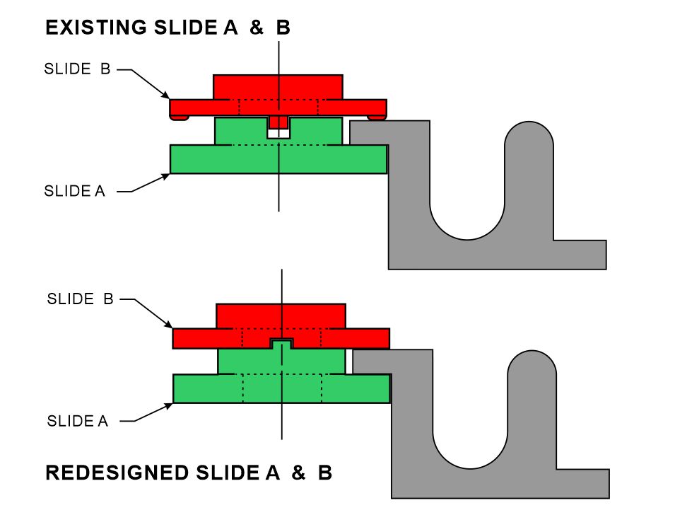

                So, I'm going to redesign the two slides. Slide A is really okay the way it is, but slide B has that protruding pin on the bottom which is a challenge for 3D printing. I think if we remove that pin and replace it with a slot instead, then "B" will be an easy print. On "A", we'll take that notch out of those "pillars" and make it a pin or higher protrusion that with make with the new slot we've made on "A". The locating function between "A" and "B" will still be there, only reversed. I doubt that I will get that today, but will try.

                  Attached is a Zip file containing six files; one each Slides A and B SketchUp files, one each of Slides A and B exported from SketchUp as STL solids, and one each of Slides A and B after the SketchUP exported STL files were imported into AutoDesk's 123Design and then exported as STL solids.
                  Hopefully the last file set from '123Design' will have better structure as everything in that program is a 'solid'. Here are two screen shots of what the 123Design Slides look like:

                  Also, I've been thinking about the challenge of printing Slide B, with the protrusions on the bottom I would think printing would be a problem. Here's a profile of how they fit together to provide a sliding guide for the SMT table over the bottom tray (the long black aluminum plate.
Name:	SMT Slide Redesign.jpg
                  Note that the pins and edge protrusions are removed from Slide B to make the bottom of it flat. A small groove at the edge is added on each side, but it is narrow enough that hopefully the printed fiber can bridge it. The base is slightly thicker to maintain the original's thickness. Slide A has the original groove in the 'pillars' removed and a protrusion added to fit into the new groove of Slide B. The 'pillars' are raised slightly so as to diminish any clamping on the guide rail that might be caused by removal of the edge protrusion on the original Slide B. (Without that "edge", there's more surface on the redesign to contact the bottom tray.
                  Do any of you see any problems with this? If not, I'll make new 3D drawings so we might be able to print and test it.

                    So this file doesn't contain the new designs, right? I will send you a PM.

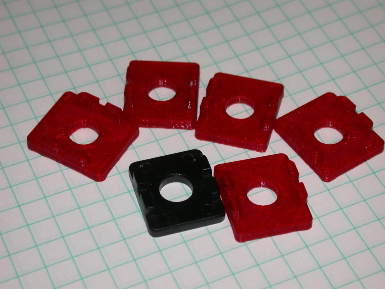

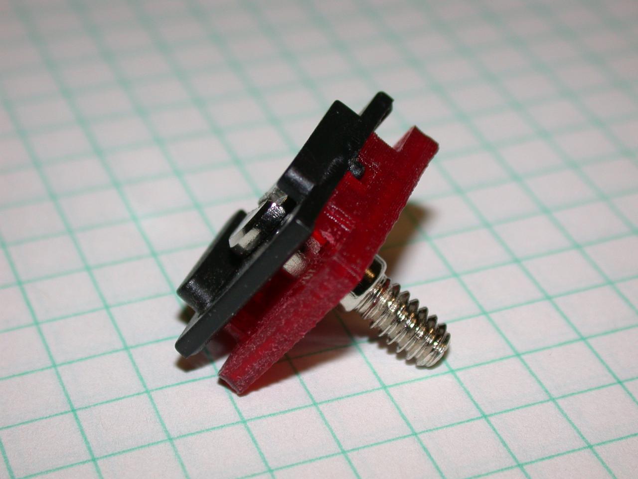

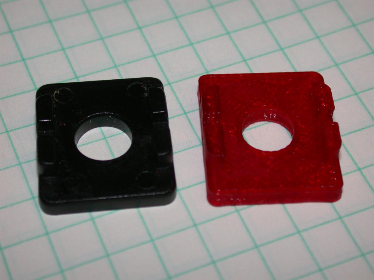

                      I received a small package of "Slides" from Paul on Saturday and I think we have a winner here, at least with the BT3 Slide A which I understand is no longer available from normal supply avenues.
                      While Slide B examples are definitely a problem with protrusions on both sides; the Slide A challenge seems to be successfully accomplished. Paul printed a half-dozen examples of Slide A and they are all dimensionally consistent. Checking them against the original and the detail drawing, they are very close, but slightly oversized about 0.005" in some dimensions. Mainly the bottom thickness was 0.119 instead of 0.114. and thus the overall thickness effected. That could very well be the result of a couple of conversions exporting the original SketchUp drawing to Metric via the conversion to print-compatible "STL" file format. Never the less, it seemed to work very well once mounted. About the only work required to get the new printed Slide to fit was to ream the center hole with a small file. I can revise the SketchUp drawing to make make up for the print difference I think.
                      I'll now finish up my redesign of both Slide A and Slide B, mostly to make Slide B printable. That way we can have a new set (A and B) to print when Paul returns from his vacation.
                      So, I think we have a viable solution to any manufactured shortage of this part: 3D print them!
                      Here are a few photos to see the new part and how well it fits:
