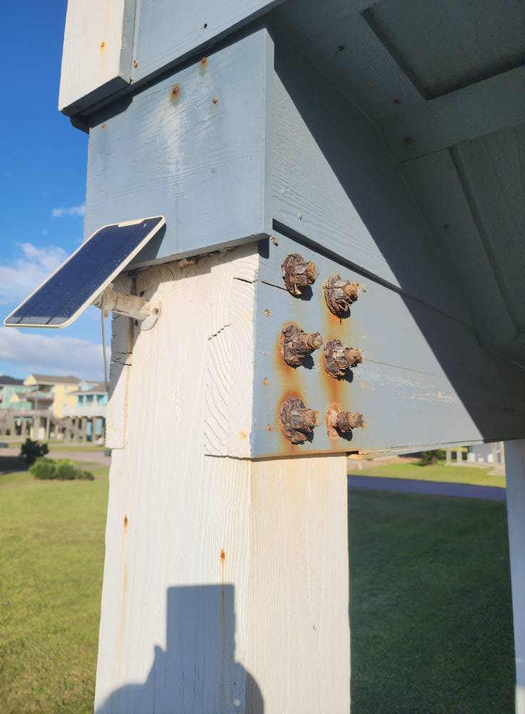

    I spent the weekend at a beachhouse rental. Built in 2008 so 17 years old.
    The house had the second story and third story up on stilts above a concrete foundation/parking area and a small storage garage/shower. The stilts were I guess 12 x 12 and probably 25 (5x5 array) supporting the house; on the top of each column/stilt there was 1 sistered and one single wood beams running horizontally to support the structure. Each beam had 6 bolts and nuts fastening it to the column/stilt.
    If I had seen this the first day I might not have stayed.

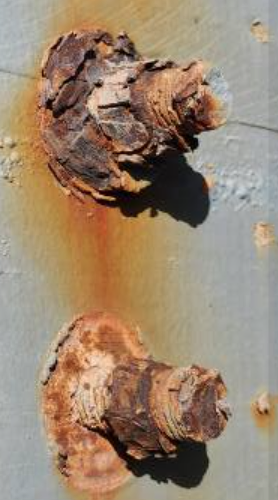

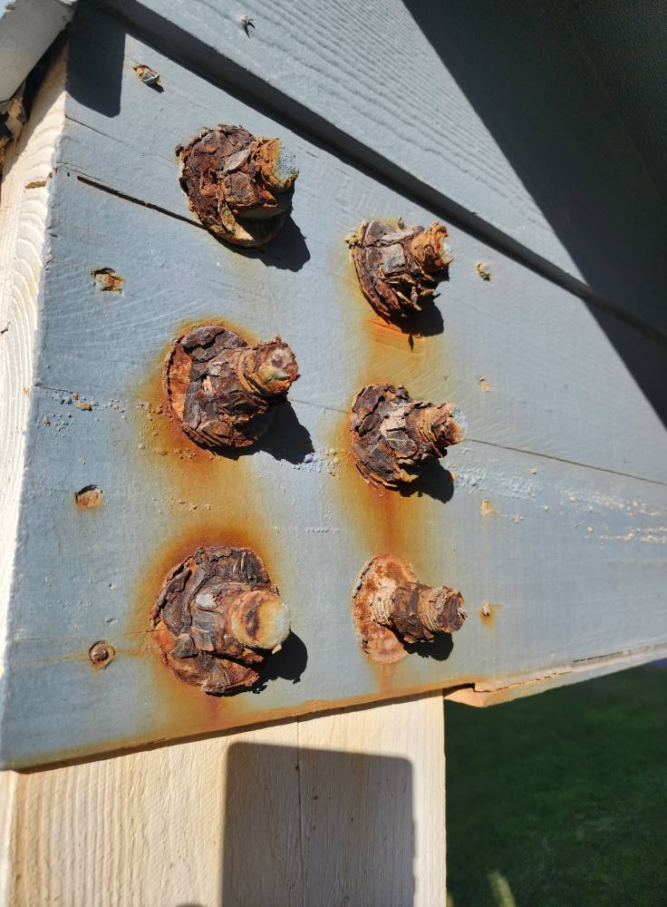

    Look at the ends of the bolts on the beam I could get to near the stairs. Not much of the Nut remains... in fact one is completely missing, I bet I could knock the other 5 off with a hammer and a small screwdriver.
    Rust never sleeps.

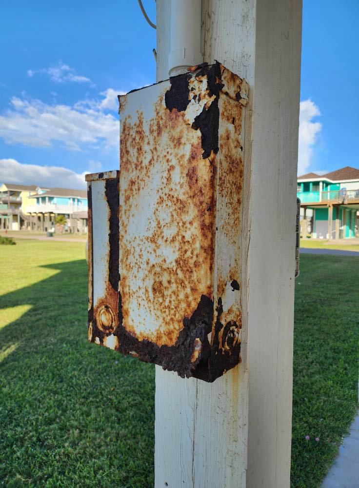

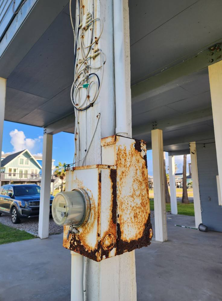

    Check out the breaker box rust.

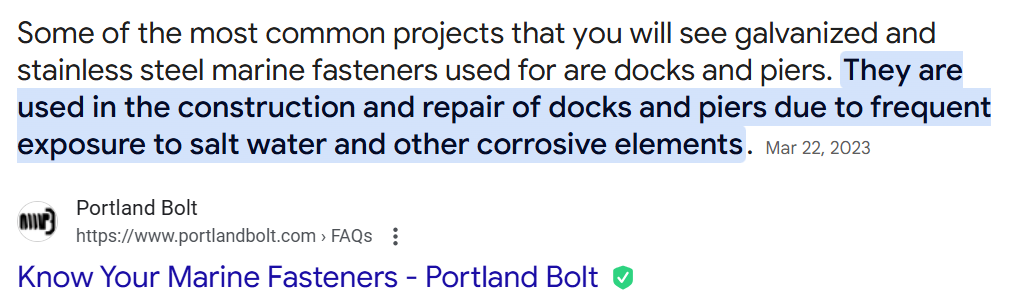

    I looked at the bolts from the other side and their hex heads were all intact and the threaded ends on this side appear to be intact, However the nuts and the washers if there were any appear to have been severely affected by the salt atmosphere (800 feet from the Gulf of America/Mexico) and simply eaten away by rust.
    My presumption (not a structural or metallurgical guy but an engineer), is that galvanized fasteners should have been used.
    Click image for larger version  Name:	image.png Views:	0 Size:	78.8 KB ID:	861901
    I suspect that non-galvanized, probably just low grade zinc-plated steel fasteners, were used and that they have rusted away.
    Stainless steel is an option but costs a lot more than galvanized.

      That close to constant salt spray should have been stainless steel. Even galvanized won't put up with that very long...

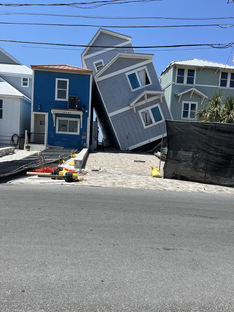

    You would think that whom ever built these rust magnets would know not what to use. The condo that we like to stay at the beach just finished repairing their parking garage that had cracks and rust drool everywhere. The contractor cut out every crack, cleaned and smeared in some concrete goo. It will probably last 5 years before it will have to have some serious repairs. This repair took a year. This is probably because they didn’t use coated rebar.
    A privately opened 3 story rental has a balance problem. it’s located next to our favorite condo, and has been in this condition several years. Owner wants neighbors to sign a hold harmless agreement so he can demo it. Ain’t happening. Their buildings have been vacant the entire time too.
    Supposedly “someone “ cut a few corners on the piling and bridge supports. When one failed and shifted it dumped the building on the neighbors. A small twister did minor damage to nearby buildings and started this fail, but it, like rust was inevitable. Click image for larger version

      I had to laugh at the hold harmless bit. Harm has already been done. There is no harmless here. It is the owner of the fallen buildings responsibility to mitigate any and all further damage in as much as possible and to compensate the injured party (neighbor with home damaged by theirs) for any damage or injury. Delaying this only ramps up the price tag I am sure.
          Supposedly “someone “ cut a few corners on the piling and bridge supports. When one failed and shifted it dumped the building on the neighbors. A small twister did minor damage to nearby buildings and started this fail, but it, like rust was inevitable. Click image for larger version  Name:	IMG_2173.jpg Views:	99 Size:	150.3 KB ID:	861903

            Yep, Panama City Beach, 5055 Gulf Dr. , between Seychelles and Treasure Island condos.
            Id bet it will still be untouched this time next yr.
              That leaning house brings back strong memories of the house that my good friends (also missionaries) lived in - in Kobe Japan when the Jan 1995 earthquake that killed 6000 struck. The houses in his area were built strong, but several became detached from the foundation. Like boxes they stayed together but leaning severely in different directions. Problem was - the following 3 to 4 days of aftershocks made each one shift to a different angle. I went there daily on my motor bike from 35 miles away to take bottled water and other needs before a good system was set up for helping everyone.
