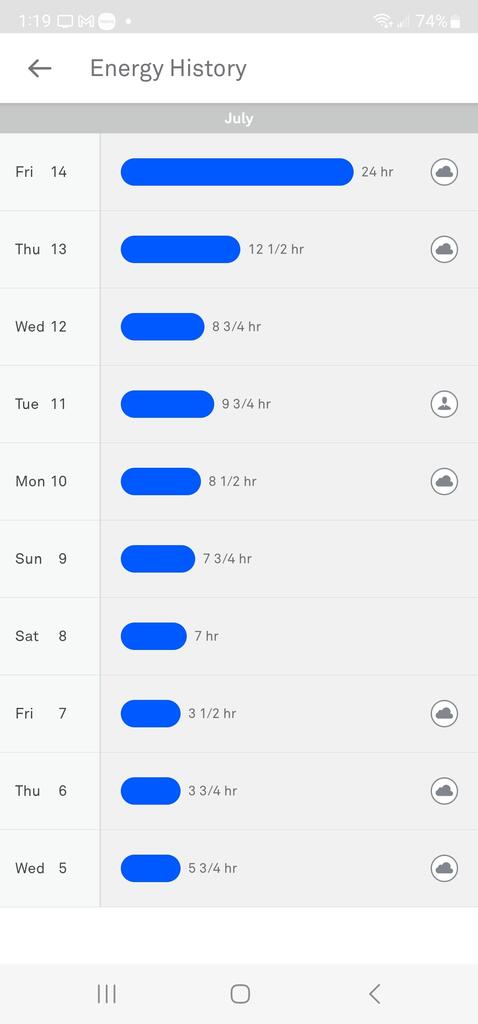

      My downstairs Central AC just died.
      Its been around 100° F every day for the last week...
      You can see since Sunday its been running about 8 hours a day total to keep the temperature at 76.
      Thursday it struggled and ran 12 hours and was hitting 79 at the end of the day,
      Friday the AC ran all day and was only keeping it down to 83. And that is probably only because the Upstairs AC was running much harder.
      Just had a A/C guy out and he said my system was fully charged, but the compressor pressure was low, probably failed.
      Looking at a new Compressor now...
