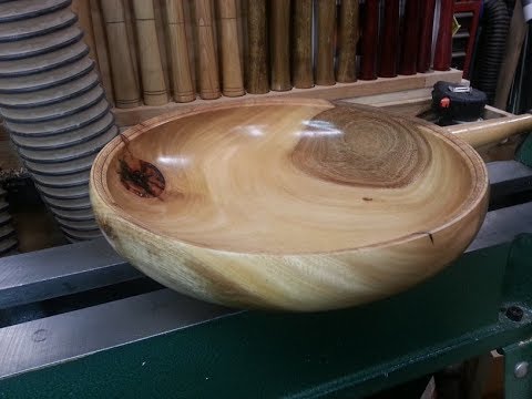

    Its been too hot to work in my shop lately (no AC), but I needed to turn something, so braved the heat - and out came this wide shallow bowl. The dry blank was as hard as dry white ash, lots of tool resharpening. Hope the weather cools off and I can get back out more. Video linked below - thanks for watching.

    Very nice. I always have a heck of a time with the nipple at the middle, and was looking forward to seeing how you did it. Then you cut that part out.... LOL
      Thanks Carlos. Yeah, some content has to hit the editting room floor - but I typically reduce the "tower" to a "nipple" using a bowl gouge, then deal with the nipple using a broad round-nose scraper; I have the 1.5inch wide round-nose scraper from PSI (Benjamin's Best), re-ground to negative-rake. I use it at the centerline, working from the center of the nipple down toward the bottom of the bowl until it leaves a slight central concavity, then I work the bottom of the bowl inward from near the wall toward the center, until flush with that concavity.

          I think we have one of those, I'll have to give it a shot. The wife is the real turner here, I just use it every couple years so she fix what I screw up.
