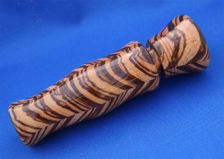

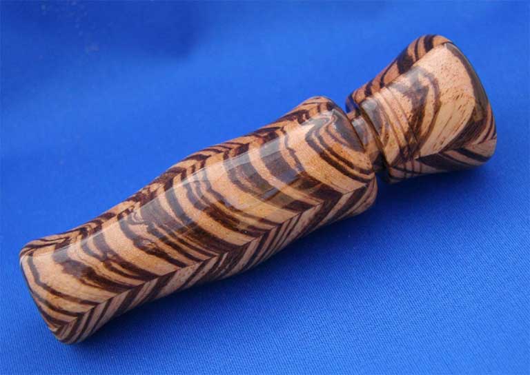

    Here is my first duck call - made from Zebrawood. It is for my 9 year old grandson in Arkansas.
    I didn't have a good picture to go by and the reed unit was not what was pictured. I had to make it to fit a small hand.
    I don't know whyat I am getting a double picture, - If you know let me know.
    Double click on the second picture and you will see the shine of the finish - very glass like. I used CA (super glue) as the finish.

    Cool looking duck call, Hank!

      I don't know why the double picture Hank, but the Grandson will be proud. It is beautiful. Bill

        The call looks great, nice work.
        The real test though is how it'll sound to the ducks

            That's real nice Hank. I really like how you alternated the grain for the glue up.

              Just playing trying to delete second picture. (delete the "attach")
              Very nice looking call!

                      Looks real sharp!!!

                        Nice work. Plans/Inspiration?

                              Inspiration, but more guessing than anything. The zebrawood choice was my grandson's. I didn't have a large enough piece to make it from a single board. Drilling the hole exacty centered was easy on the lathe.
                              I am not pleased with the shape. I made the long part first and it looked good while on the lathe, so I finished it. Then I turned the end part to fit. I hate to take something off the lathe and put it back on. Alignment probems often occur, so I didn't know what it would look like until I finished and put it together.
