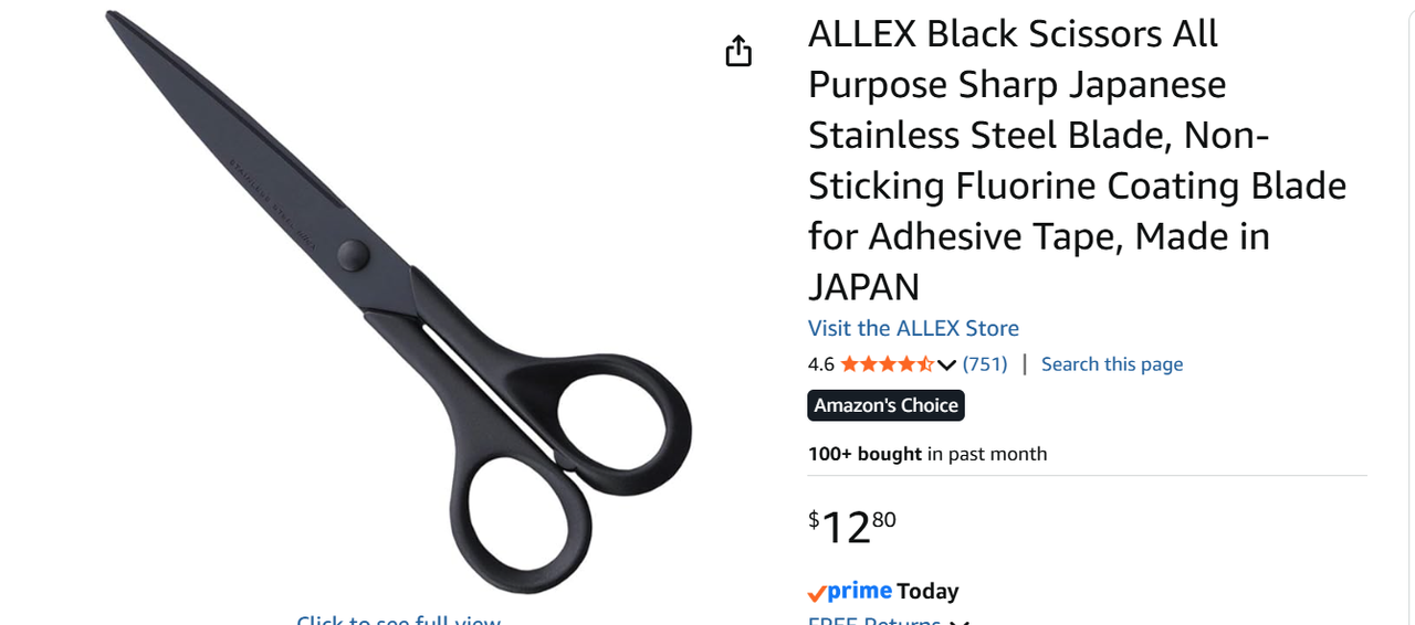

    I posed this question to AI tool as a double sided tape cutting problem and it suggested using what are available as coated scissors with flourine or with teflon to cut adhesive materials and make cleanup and grabbing less of an issue. They also recommended using WD40 on the blade to reduce sticking. I worry about WD40 affecting the stickiness.
    I tried a flourine coated scissors from Amazon and it still stuck like no tomorrow. Probably going back.

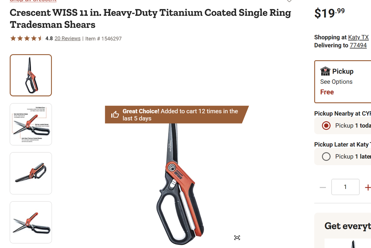

    It said because the fibrous and thicker adhesive I wanted serrated blades and recommended a Wiss 11inch shears with micro serrations.
    Click image for larger version  Name:	image.png Views:	0 Size:	313.5 KB ID:	862965
    Wasnt' cheap, but I tried them and it does cut the Xfasten tape cleanly without grabbing to the adhesive on either blade. AI sometimes gives great advice when you spell out the exact problem.
    Tractor Supply was $7-8 cheaper than any of the hardware box stores and Amazon.
    Should have had these the other day. I 'm always buying solutions to the problem I had yesterday. So I won't have them in the future.
    These are some good heavy duty cutters as well. So I'm sure I'll use them. And I still have lots of tape left.

        Thanks for the info. Allex Scissors has some weird and wonderful scissors in an Amazon search.
          Wonder if they will cut this stuff? It's the strongest tape I have ever found. I used it to attach an aluminum plate to the tank of my Harley about 10 years ago.
