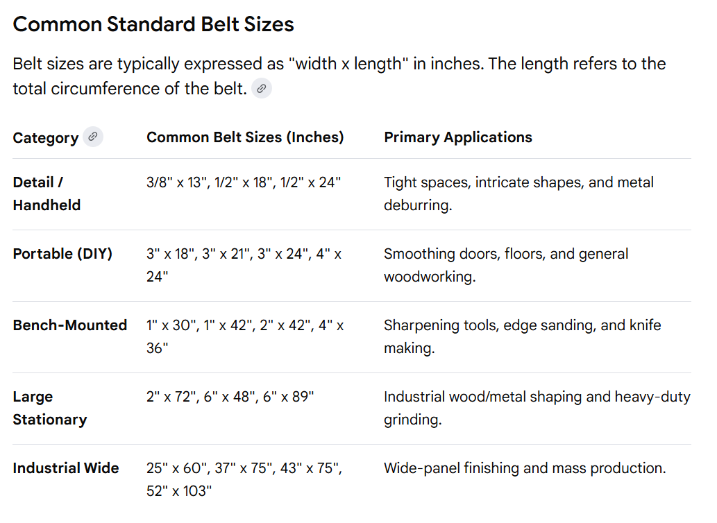

    well, 72" x 2" is a standard size, most often found in industrial sized machines. Obviously you stick to standard sizes to make it easy to keep it provisioned.
    These are standard belt sizes:
    Click image for larger version  Name:	image.png Views:	0 Size:	99.6 KB ID:	862771
    I guess the question is when would you need such a large sander?
