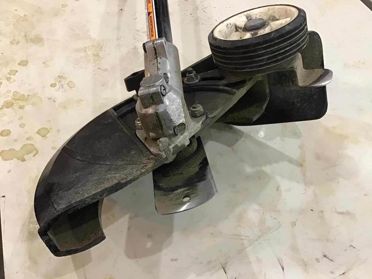

    This is about a 30 year old Ryobi sidewalk edger attachment. It's not broken....yet, but it's getting close. The cast aluminum housing has been ground away from years of use. Look at the one bolt/nut at the front. They are almost half ground away. I'm not sure how to fix this one so it lasts much longer.

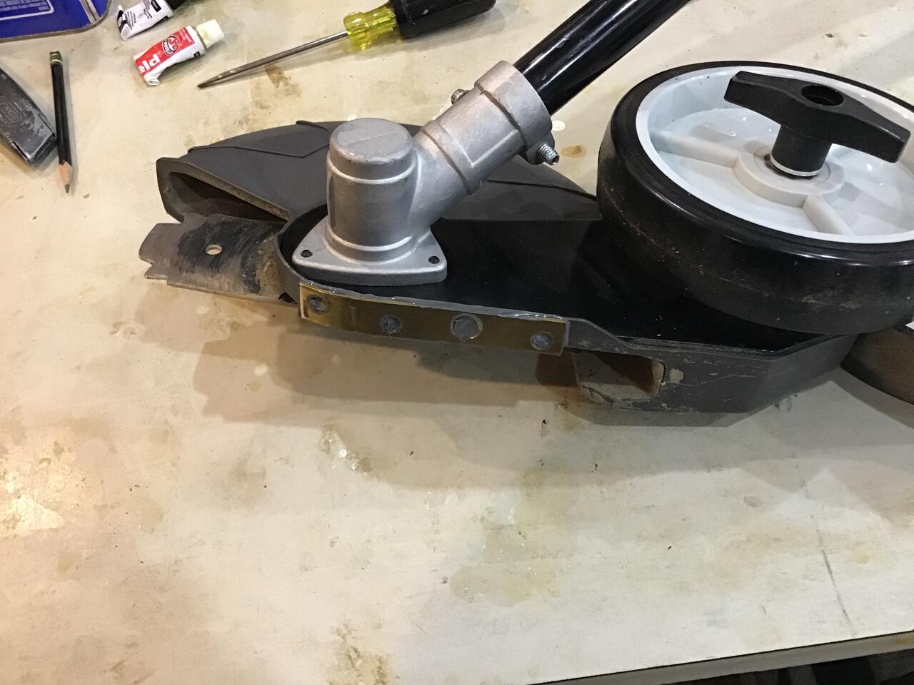

    I received a new edger attachment for Father's day and it certainly works as well or better than its predecessor. However, there seems to be a serious design flaw in it. The wear surface is a plastic covering over a steel plate frame/chassis. The wear point is already showing after two uses. I'm trying to figure out how to attach a wear plate to this one.

        I found a steel mending plate in the junk box in the shop that is an exact fit for the area at risk. I have bent it to shape and will use some JB Weld to bond the plate to the plastic part. I will give Ryobi a few days to respond before I press on with my fix.

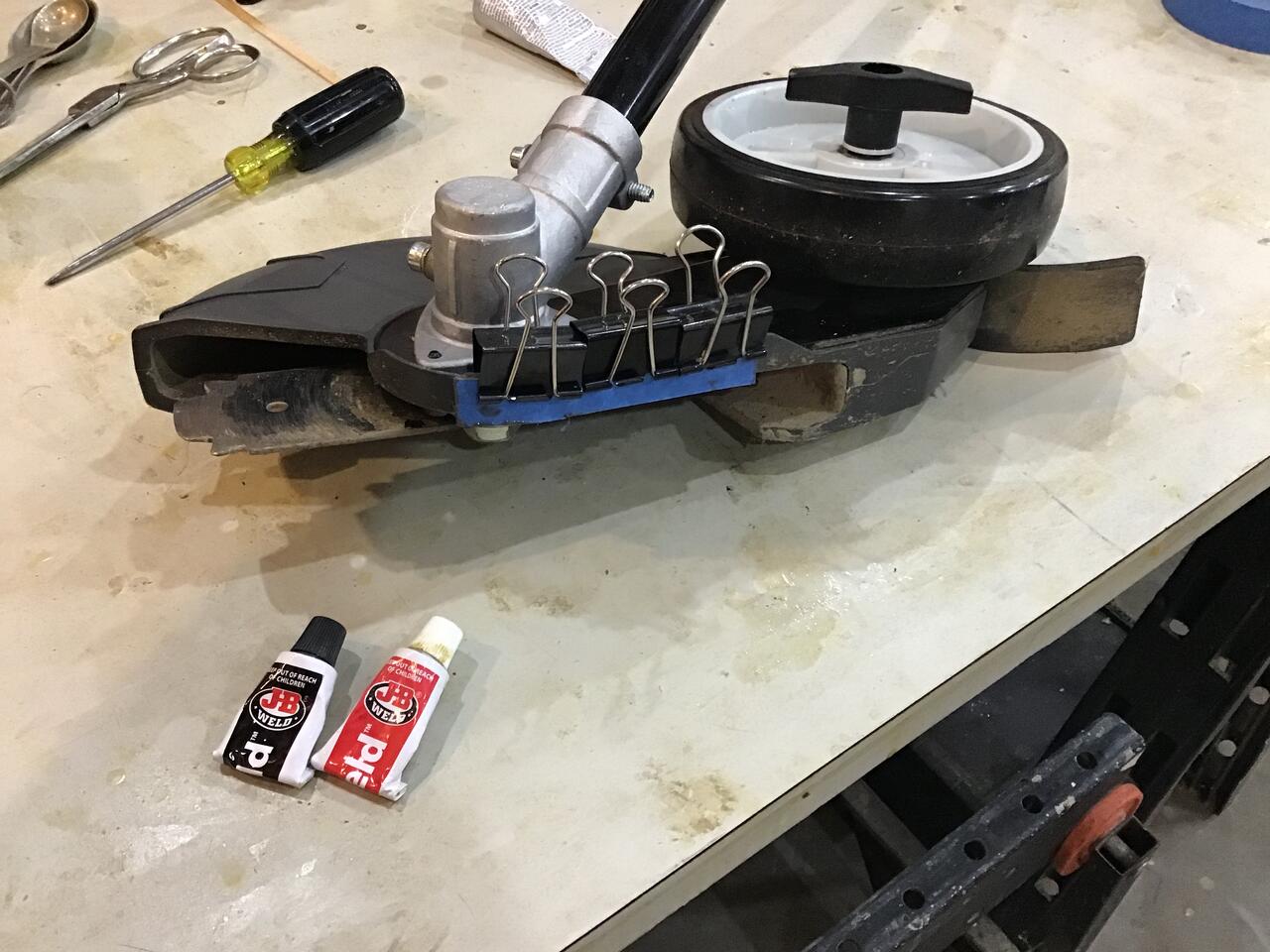

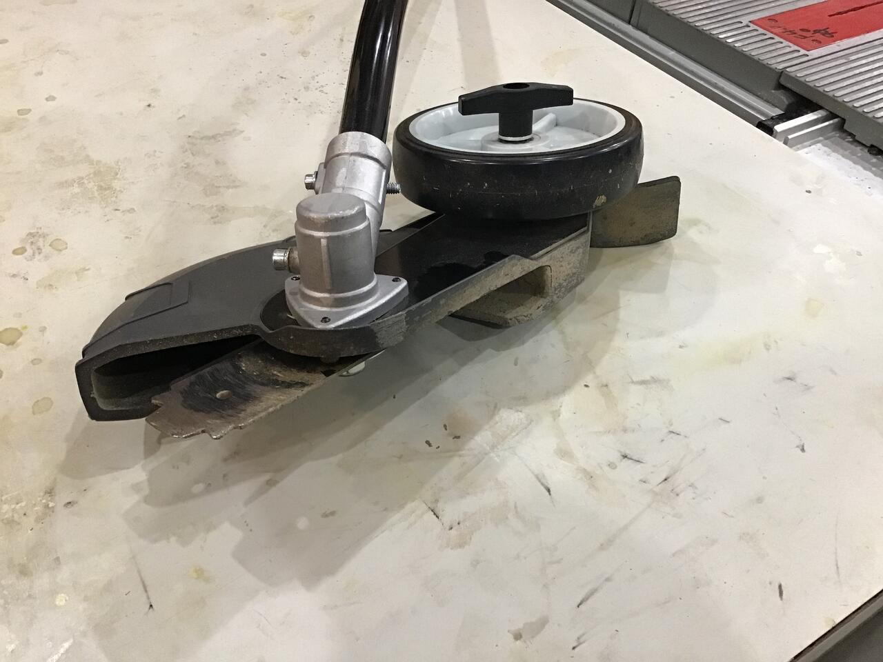

          Decided to go ahead with my repair instead of waiting for a response from Ryobi development. I bent the mending plate to follow the curve of the plastic and scuffed both mating surfaces with 80 grit sandpaper. I mixed up some JB Weld and buttered both surfaces. I clamped the plate in place for a few hours. It may be some time before I use it due to the severe drought we have here.

            probably better than new!

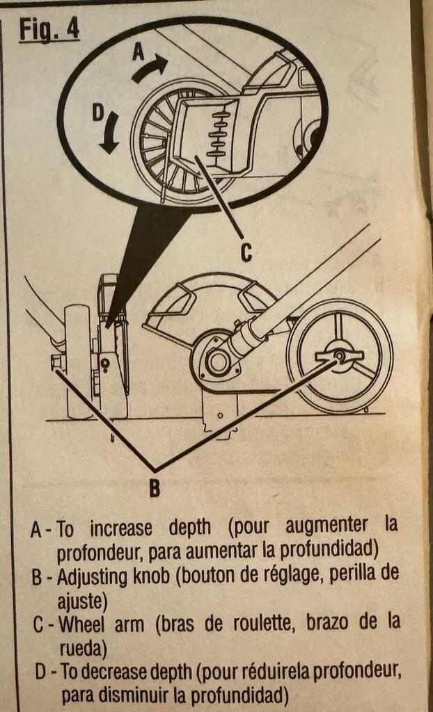

              I don't believe that is intended to be a wear plate. If you adjust the wheel to a lower position, you should be able to get it to where the area you are concerned with just hovers over the pavement you are edging. I have the same model and after 5 years there is very little wear on it and I edge about 360' of sidewalk and paved path every other week. I do like your solution

                Yes, if you are somewhat tall, it's really easy to make contact with the concrete regardless of the depth setting. Also, there is no guide flange to help you guide the tool in use. This makes it easier to put the plastic part n the surface being edged. The original was better in that regard.
