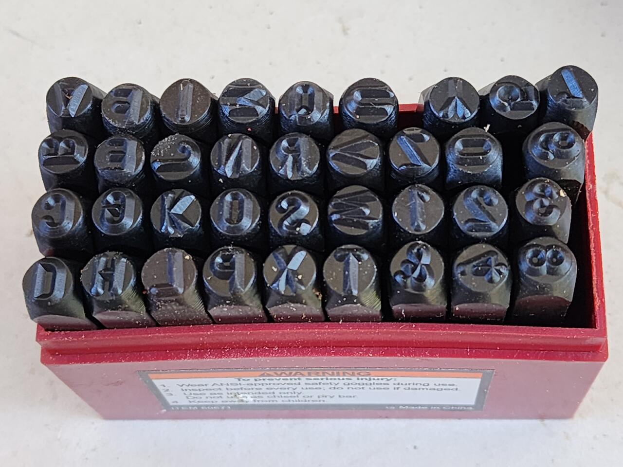

    Anyone use these cheap number-letter stamping sets to mark their work?
    1/4" size used.
    Click image for larger version  Name:	20251006_023511.jpg Views:	4 Size:	48.3 KB ID:	861958
    Click image for larger version  Name:	20251006_092407.jpg Views:	4 Size:	145.5 KB ID:	861959
    They are good for marking IDs on similar parts or for putting dates and other info on your projects.

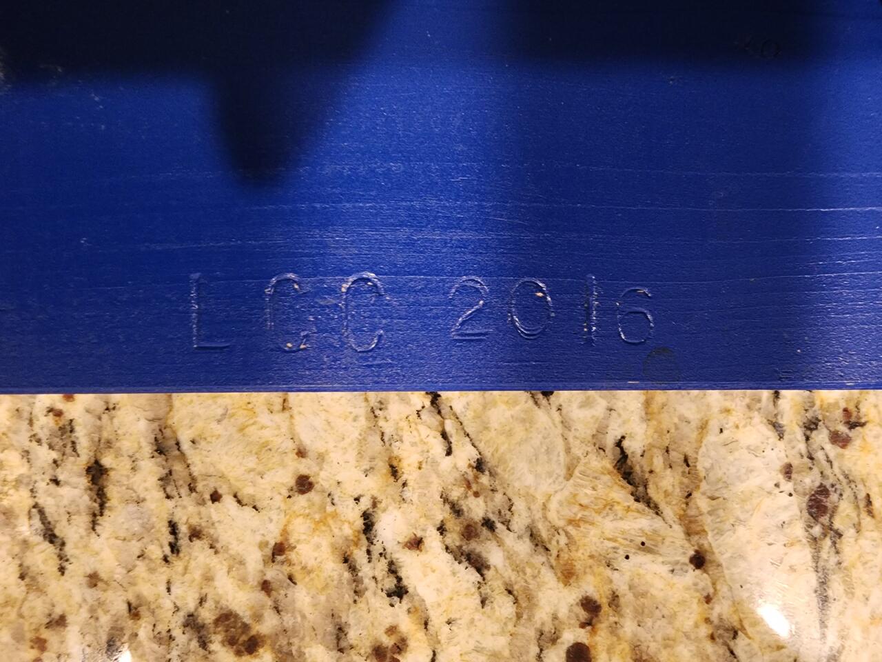

    They aren't beautiful, they can be a bit ragged looking because the spacing and alignment is all manual. but if they're in hidden areas they can be OK. I find that looking at older stuff I've done, I often try and recall the year I made it.
    You can neaten them up somewhat by using a lower bar to guide the vertical placement on a line... and using the previous letter to set up the next letter position exactly adjacent. But it takes more time and effort.
    Anyway HF has these for not too great amounts in 1/8", 1/4" and 3/8" letter heights starting at $10.. You can find other sets (HF used to sell more sizes, or try eBay); I have a 3/16 and I recall seeing 1/2" sets.
    They will also mark aluminum and even mild steel.
    Sometimes I will use my wood branding iron and then use these to mark the year.

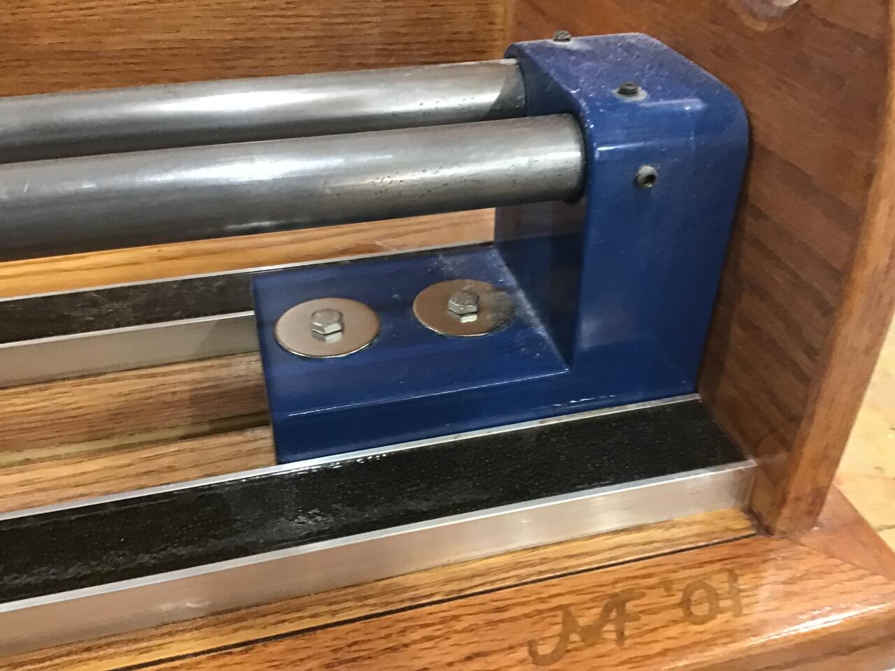

        For many years, I carved my mark and the year into the piece, filled the recess with wood putty, and finished over it with the rest of the piece. Lately, I've gotten a bit lazy and make a printed label that gets plasticized by dipping it in thinned varnish, which gets glued to the piece and finished over with the rest of the piece.

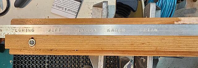

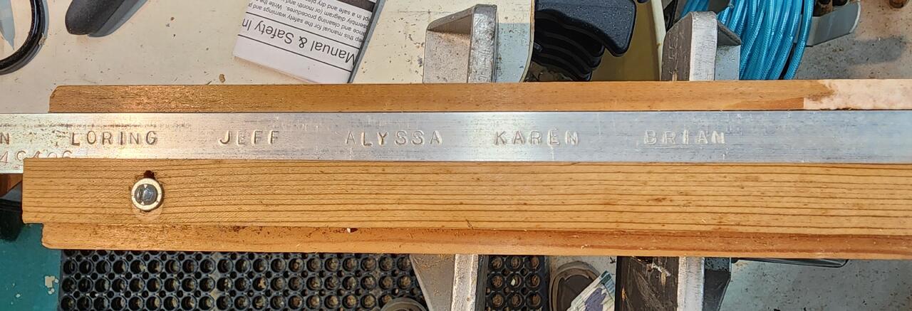

              Using a guide rail to bottom the lower edge of the stamp you can get both good alignment and letters square, as shown on this jig I made for stamping aluminum tags. Even Spacing is a bit tricky. But there are tricks for that, too.
              Click image for larger version  Name:	20251009_003313.jpg Views:	0 Size:	109.1 KB ID:	861978
                leehljp commented
                I like your lettering guide. But just now it came to me that a magnetic bar could/would work well also in many cases. Thanks Loring, for a great idea.

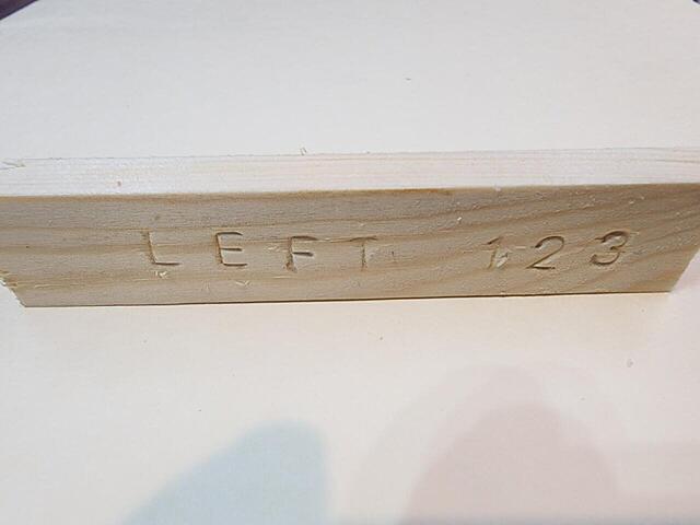

              I might also point out
              • you can buy number-only sets, 9 punches 0-9 (use the 6 as a 9 if inverted) for much less than a 36- punch letter and number set
              • on eBay there are people who sometimes sell broken sets of individual letters for a buck or two per letter. I once bought an L and a C (as my initials are LCC) in the half inch size just to personalize some items. Of course, availability of some letters can be limited if he's been selling for a while. Patience!
              Click image for larger version  Name:	20251011_024017.jpg Views:	0 Size:	163.6 KB ID:	861981
                • 22109
                How to make Horizontal spacing hint.
                If you are using a fence like I suggested, then that lines up the letters vertically and also the flats against the fence keeps the letter rotations in check.
                The trick I use for consistent horizontal spacing is to use the last letter punched held against the fence, its easy to feel when its in the impression and while holding it in its indent, place the next letter flush against it to so one side of the new punch is against the fence and the other side is against the previous letter. Then take away the previous letter and make the punch. This way you have consistent spacing. The only caveat is the "I", which being so skinny should really be placed closer to both the previous and next letter or else the gaps look a bit unnatural. Unfortunately this becomes a matter of judgement and experience for the "I".
