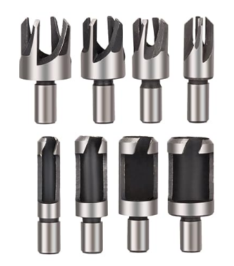

    Got a set, kinda looks like these.
    I presume the top ones are for making tapered plugs, right?
    I went to make some plugs to cover a goof hole, I used a 3/8" brad point to make a hole 1/2" deep
    I then went and cut some 3/8" tapered plugs and they are loose and slid into the hole and will almost fall out
    I thought the taper was supposed to go a little oversize so you could hammer the plugs in and fit snugly. Then cut off the excess protrusion with a flush trim saw.
    They appear to be 0.38 at the wide end and .037 at the narrow end.
    seems like it should work.
    Drilling a longer plug doesn't make the wide end any wider as the widest point is where the plug cutter tip enters the wood.
    I guess you're going to tell me now to go measure the hole....
    I did check with a 3/8" dowel and the hole is a little loose. I guess that means the hole is too big.

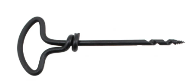

    I had to use a da*n gimlet to get them out.

    Anyone got any advice about plug cutters?

      Yes, top one make tapered plugs.
