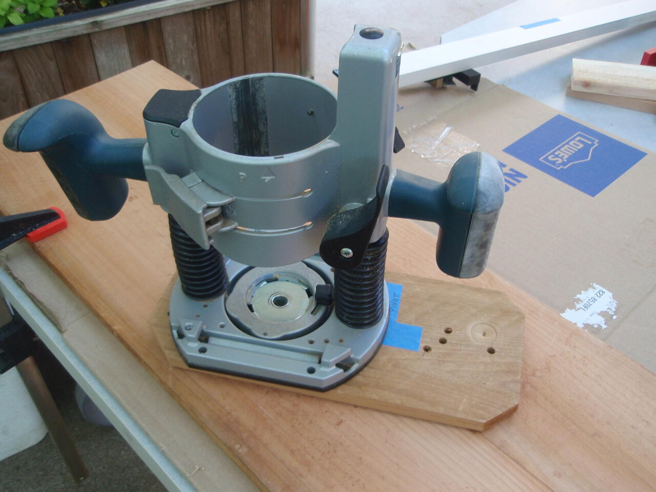

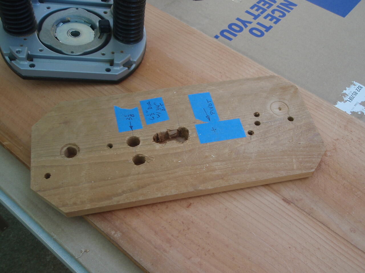

    Using a homemade circle jig - a piece of wood with a 1/4" pivot hole and a 1/2" hole for a 1/2" template guide busing in the router base. Holes separated 3-1/8" (radius less half a bit width)

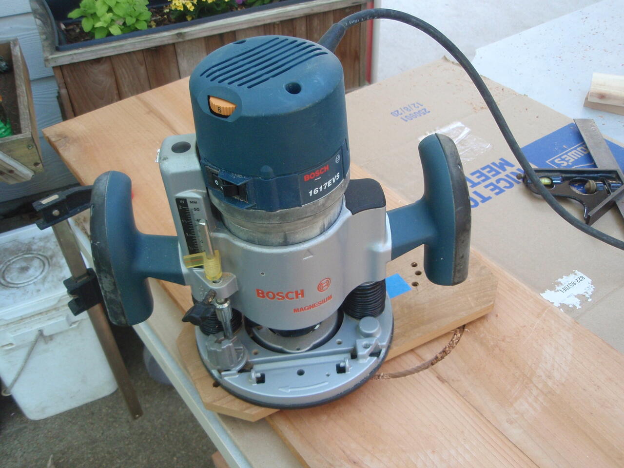

    If I were to do it strictly with the router, I'd grab a 1/8" shim, set the router so it touches the surface to be cut and then drop the depth stop rod onto the turret with the 1/8" shim between the rod and the turret . Remove the shim and plunge to make your first pass. For each subsequent pass, lock the router at the full plunged depth and reset your depth stop by adding the shim and repeat the process. I guess that would be Option B.

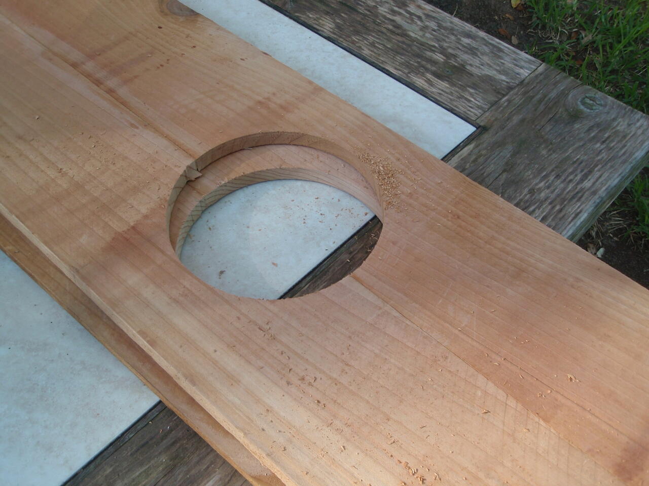

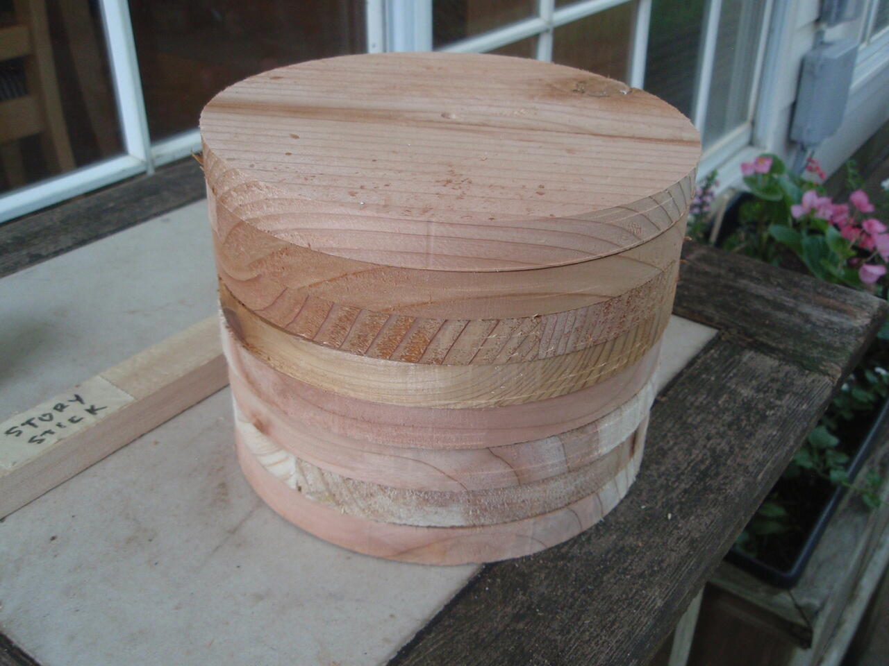

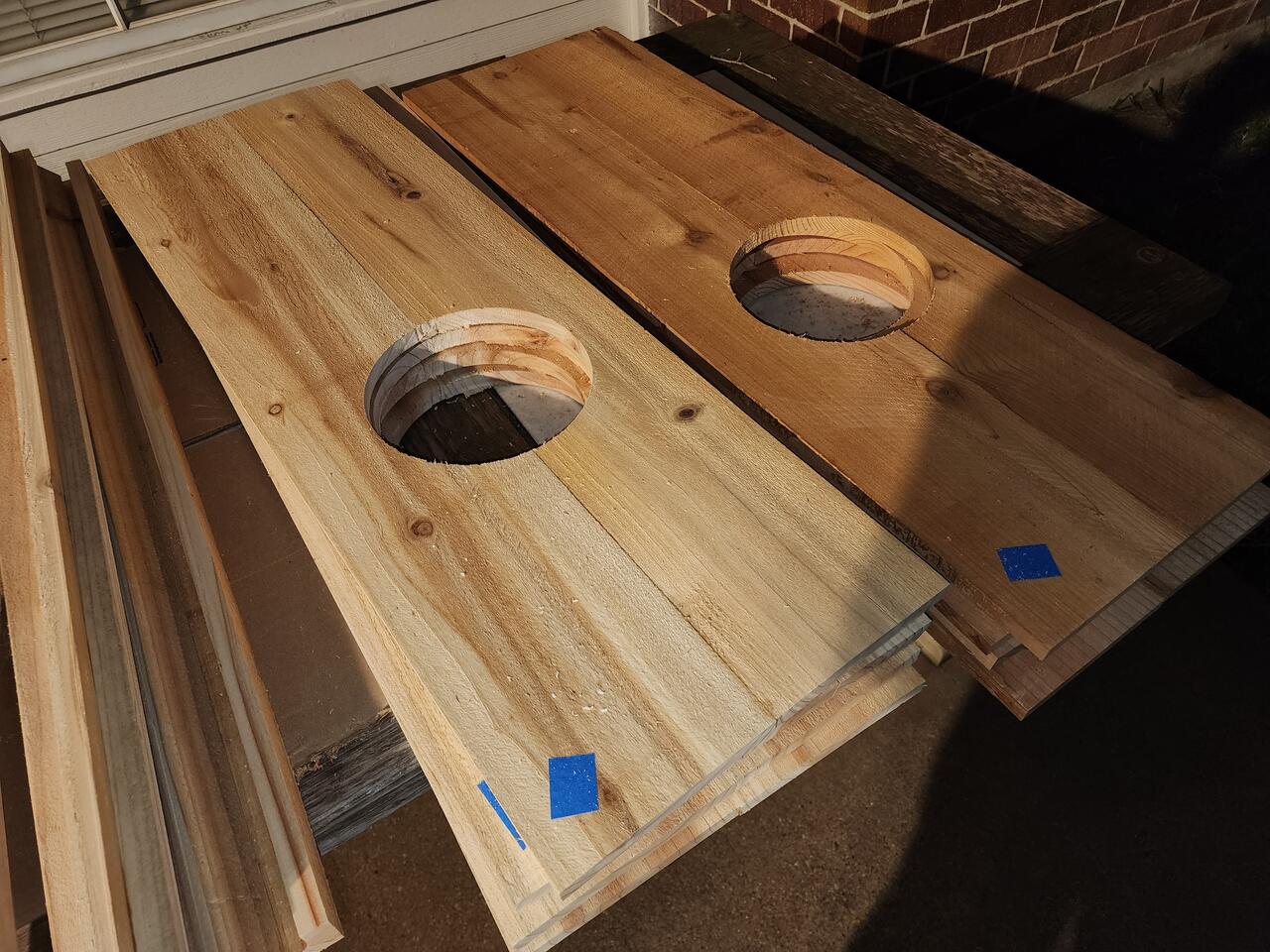

      I decided to use the plunge router - its made for incremental passes; it has that stepped turret - and didn't want to be shuffling the workpieces 48 times.
      Went pretty smoothly.
      Observations:
      • My circle jig is pretty beat up. May have to "splurge" and "buy" a new one. J.K. its a piece of scrap wood. Does have a lot of holes in it.
      • Router worked fine. I like the Bosch Quick change template guides

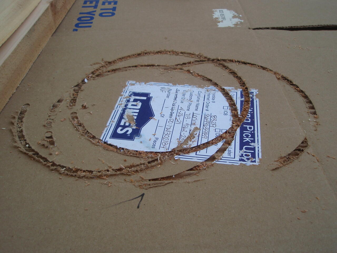

      • I thought I was clever and used a flattened corrugated cardboard box as the backing instead of sacrificing a good piece of panel wood.

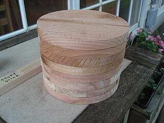

      • I got 8 free wheels I need to find a project for.
      • I had moment of panic when I pulled a set of brand new spiral bits and they were all too short... apparently 1-1/2" overall length. Fortunately I found a 2" OAL one in my box of bits that did the job.
