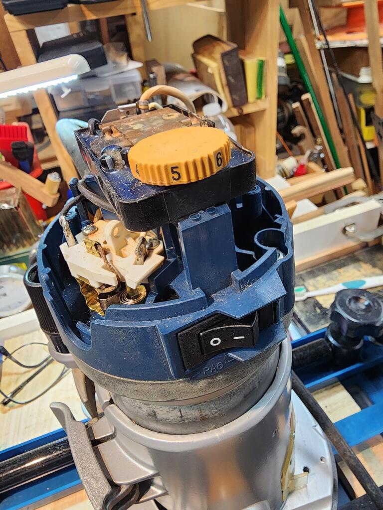

Argh, went to use my old Bosch 1617evs and the power switch is intermittent.
    • 22011
    Problem with the older Bosches.
    Back in the pre 2005 days they did not use a sealed switch and dust got in them and made them intermittent.
    I found I had squirreled away a pair of replacement switches. But I'll see if I can blow it out.

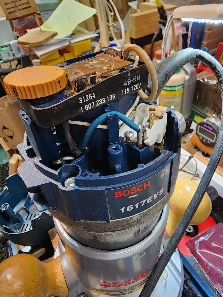

    Blowing it out didn't work.

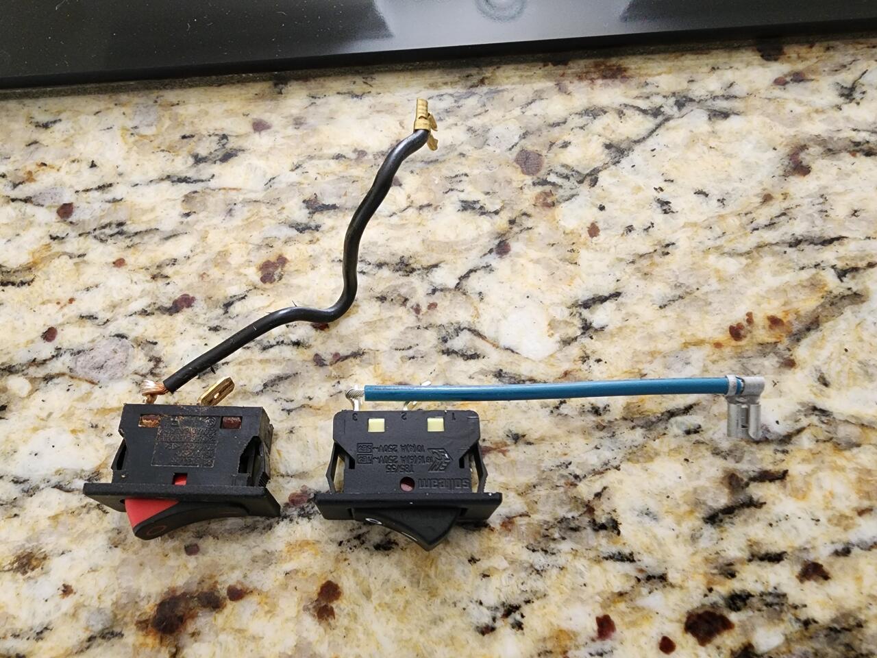

    Old switch and replacement I ordered years ago (March 2020)
    Fixed now.

    You tube videos said the cover was held on by T15 Torx screws. It was in a deep recess so I dutifully stuck a T15 driver in and did not "seat" the head.
    Turns out mine is so old it had Phillips screws.
      capncarl commented
      Boy that type of switch is really a sorry cheap piece of junk.

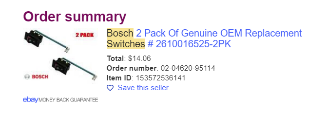

    I have no recollection of buying these switches... FOund a receipt from March 2020 from an eBay vendor for a pair of them
    Must have been a premonition to have bought them then.
