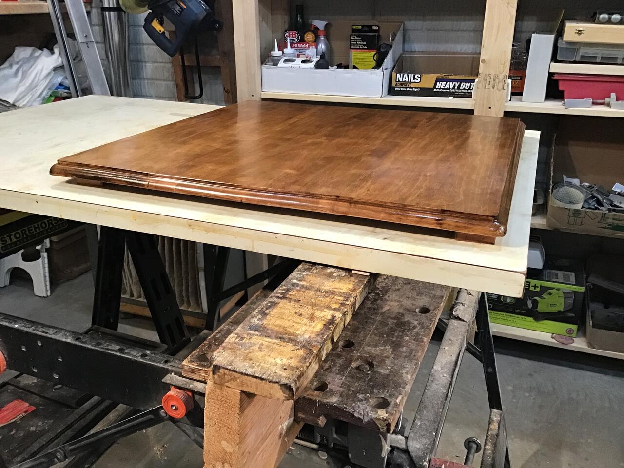

      Don't have the HF model, but did buy the Wagner Flexio 3500 handheld machine to paint the basement concrete walls. It was recommended to thin the latex interior paint (SW CHB white) 10% for spraying with the regular nozzle. Worked really well. I also used the sprayer with its detail nozzle to spray a table top with MinWax polyurethane semigloss varnish and the finish was flawless. The poly was thinned about 20%. Unit is really easy to clean after use. The Wagner unit is twice the price of the HF unit, but has more adjustments and power than the HF model.
      Added thoughts. 1. if the paint has to be thinned 50%, it tells me the gun is a bit low on power/air flow. 2. The applied paint film will be pretty thin and you may have to recoat the walls. 3. None of the handheld HVLP sprayers I reviewed could spray unthinned materials.
