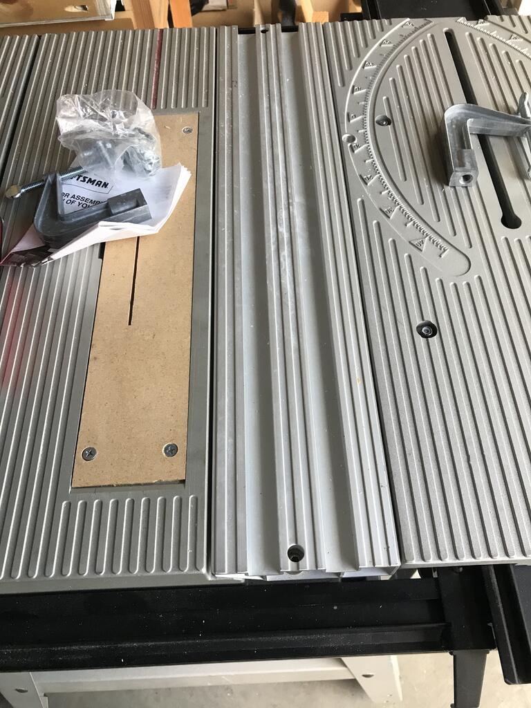

    I picked up this old but unused still-in-a-box Craftsman Universal Table Saw Jig at a yard sale a couple of weeks ago (first 4 photos).

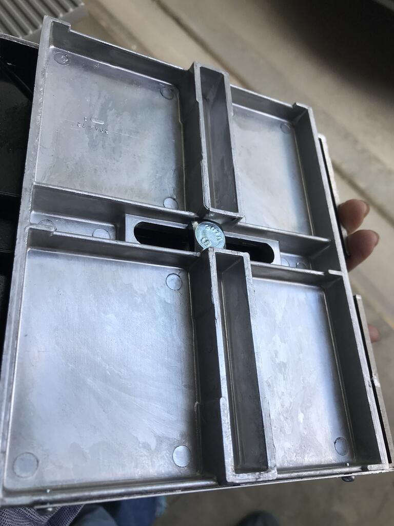

    Looks very interesting and thought it might come handy with the miter slot accessory that I acquired just before my injury last year (see last photos).
    Then it has occurred to me that the craftsman jig has an aluminum base. The miter slot accessory is also aluminum. Will that be causing aluminum over aluminum friction and wearing out? What does the hive mind think?

    I think it will likely wear over time, but I've been using a steel miter gauge on an aluminum table Shopsmith for a decade and can see no discernible wear. Other Shopsmith users have been doing the same for half a century or more. I do wax the table and the miter gauge frequently with Johnson's paste wax.

      Good to know this - so for an occasional usage like mine, I guess it will probably outlast me .
