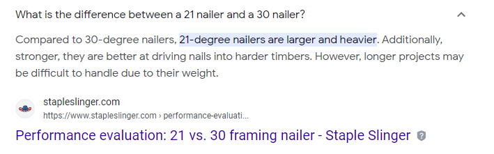

    Click image for larger version  Name:	image.png Views:	0 Size:	120.5 KB ID:	855125
    2nd hit
    Click image for larger version  Name:	image.png Views:	0 Size:	36.5 KB ID:	855126
    about the 4th or 5th hit - long article, summary paragraph after link

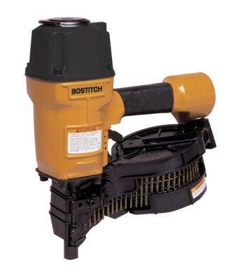

          Just to mess with you, here is a 15 degree framing nailer. I've had this same Bostich N80-CB nailer for 20+ years. It uses nails in wire collated spools at 15 degrees. Nails for it are full head and up to 3 1/4 inches so they'll meet most framing codes.
          PROS:
          • It is compact, not as long as a stick nailer so it is easier to handle in tight spaces (between floor joists)
          • Nails for it are available everywhere and consistently stocked at Menards, Lowes and HD.
          • It is indestructible as far as I can tell.
          Cons:
          • Heavy, and even heavier with a full 300 nail coil in it.
          • Reloading nails takes a little longer than with a stick nailer and even longer if you are changing nail sizes.
