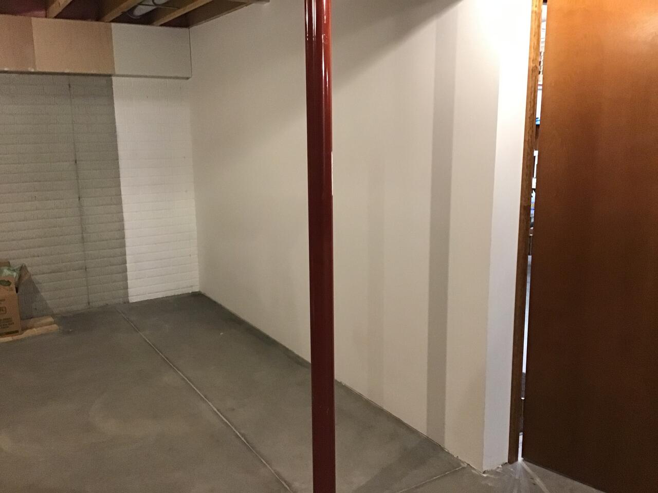

    Just used my new Wagner Flexio 3500 HVLP sprayer to paint bare drywall/concrete walls in the basement. First use and it went flawlessly. I sprayed four year old SW CHB white latex strained and thinned about 5%. No runs, no sags, no clumps, and no clogs. I may never use a roller again. Click image for larger version

    My son in law has the same model and we used it last summer to paint a dresser. I was surprised at the quality of the job it did for the price of the unit. The finish was comparable to what I would have gotten spraying from my far more expensive Fuji system. We were spraying Sherwin Williams Emerald cabinet paint and only had to thin it about 4-5%
      Spray painter cleanup is an absolute necessity. That time must be figured in. BUT the results of a quality spray painter is far and away better than I can do with a roller or brush, no comparison.

        It took a bit less time to clean the unit as it would have taken to clean a roller, roller cover, tray, and brush. And I didn't have to wait for the roller cover to drain and dry.
