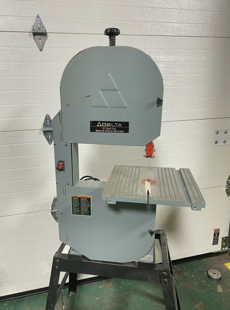

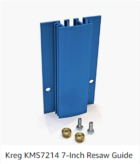

    I have a kreg 7" bandsaw resaw fence
    Click image for larger version  Name:	image.png Views:	9 Size:	36.1 KB ID:	854260
    And a 12" Delta Bandsaw. - The bandsaw only has a 6" resaw capacity (6" clearance under the upper wheel housing and under the blade guide)
    So the resaw guide fence is too tall.
    Kreg also sells a 4.5" version of the fence. But I already have this one for reasons I can't even recall.
    I think I am going to cut the fence down into a tall version and a short version.
    I'm thinking
    5" & 2"
    4.5 and 2.5
    or
    5.5 and 1.5
    so I can use on my Delta BS.
    Any suggestions which would be better?

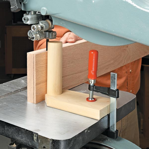

          I likewise have the Kreg bandsaw fence, but not the resaw attachment. Could someone please explain to me how these tall but short front to back resaw attachments work. It would seem to be a guarantee to have the cut wander... But maybe I don't understand the theory...
            Internet Fact Checker
            • 20920
            Bandsaws tend to have drift, because the blades are narrow and flex, that is hard to get to follow a line truly perpendicular to the fence and miter slot.
            Immaculate tuning can only do so much because you have the position centered on the crown of the wheels, the upper and lower guide blocks and rollers and thrust bearings and even the feed rate and pressure.
            Resawing a 1x4 (actual size 3/4" x 3-1/2") is making it into a pair of 3/8" thick by 3-1/2" boards, less the kerf of the bandsaw, about .025". along the thin dimension, making it even thinner. Its a vertical rip.
            Because of the drift you can't just use the bandsaw fence as a rip fence for normal rips or resawing. It would either drive the board into the fence or walk it away from the fence and you don't get a cut parallel to the edge of the board like you expect.
            So this gives rise to the of the resaw fence, One that is tall so you can control the piece absolutely vertical for uniform thickness top to bottom, and a slightly curved face so you can place it the desired thickness from the blade and allow you to keep it feathered against the face and yet adjust the feed angle to follow a line you have scribed on the top edge of the board to follow.

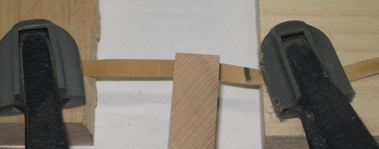

                          Something many folks never do when setting up their bandsaw: adjusting the table miter slot to be parallel to the blade! Mount a wide blade, tension it normally, adjust the tracking, set the guides properly, etc. Then place a thin metal rule against the blade body so it passes between blade teeth - avoiding any tooth set. Use this as the reference. Adjust the table so the miter slot is parallel to the blade and metal rule. Then set the fence parallel to the metal rule. That's what I did with my Rikon BS and I get straight, drift-free cuts, with decent blades. I've made test veneer pieces, about 1/32nd of an inch thick, from a chunk of crappy pine as a demonstration/test... using a 3/16ths inch 10 TPI blade. Normally one would mount a much larger blade for resaw work; I did this as a demo to show you can resaw with a good/quality blade. This resaw was done with the stock Rikon rip fence, not a point contact or resaw fence. I use the "center the blade on the crown" technique, not the "center the teeth or gullet on the crown" technique. The Rikon BS uses guide bearings which I position very close to, but not actually touching, the blade. The upper wheel/tire has the crown; the lower wheel/tire is dead flat. The crown is not very large either which I think makes a difference. A large crown makes wide blades "teeter-totter" on the hilltop. Many bandsaws come with what I believe to be an overly-pronounced crown as that probably makes tracking adjustments easier for rookies. For most resaw work I do install a 1/2 inch blade... but this demo was for some friends of mine just starting out in woodworking. I wanted to show them that you can do things without having to buy a ton of blades.

                          I don't have an aftermarket blade tension gauge; I adjust blade tension using the "push with a fingertip technique." I set the upper blade guides about 6 inches above the table and adjust the guides to be very close to the blade. Then I push mid-way between the guides and table with my fingertip (using the flat part with the fingerprints, not the very tip/end of the finger) just hard enough that I can see my skin turning lighter underneath and next to the fingernail. The tension is adjusted to get no more than 1/4 inch blade deflection with that much finger pressure. The Rikon BS does have a tension display inside the upper wheelhouse which gets me close.

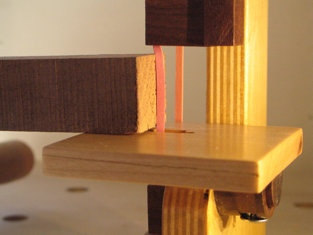

                          When I adjust the guides, one thing I am careful to do is to make sure the distance between the blade back and the thrust bearings is small but more importantly EQUAL between the upper and lower guide assemblies. If the blade hits one thrust bearing before the other, the blade will want to twist more than usual... especially if the lower guide bearing has excess clearance. As part of the lessons to my friends, I made a sample bandsaw from wood using a thick rubber band as a blade. The goal was to demonstrate how blade tension stiffens the blade via "beam strength" theory. That little toy made it easy to show how the rubber band blade would a) bow backwards when the workpiece pushed against the teeth, b) how it would then flex laterally especially when the tension was low, and c) how having the thrust "bearings" not equally aligned made the rubber band blade skew/twist.
                          Click image for larger version  Name:	IMG_4205.jpg Views:	0 Size:	131.4 KB ID:	854321
                          The rubber band "blade" is getting shoved backwards by the walnut workpiece. You can see how it kinks below the dark upper blade guide. And how the blade is just beginning to twist. With less tension it would have already twisted 90 degrees to sit flat against the workpiece. You can do similar experiments clamping a rubber band across blocks on your workbench and pushing a stick into it. Stretch the rubber band more to "add tension" to the system and see how different it flexes and how much further you can push the workpiece before the rubber band blade twists and would start cutting a horrid path.
                          Click image for larger version  Name:	Bends_and_Twists_at_low_tension_3723.jpg Views:	0 Size:	55.0 KB ID:	854322
                          Now, I have not done tons of resawing so I can't say my technique - tracking the blade centered on the crown and very little gap to the blade guide bearings - will work 100% of the time. It has worked for the dozen or so times that I've resawn. Pine boards, 2x4s, oak boards on-edge, maple boards on-edge to make 8/4 stock thinner, some walnut... that's what I remember doing over the last few years. Generally up to 6 to 9 inches tall; I have not resawn anything utilizing most of my Rikon's full ~13 inch resaw capacity. I also used a Craftsman 10 inch BS (the one that looks remarkably similar to Rikon's 10-305 BS and shares many replacement parts with it) to make bandsaw boxes. Slicing off 1/4 inch to make the back panels was done with the rip fence aligned parallel to the blade as well. Those bandsaw boxes actually exceeded the stock vertical capacity of my Craftsman BS; I made a replacement table that sits on the lower wheelhouse, giving up any ability to tilt it, to gain almost an inch of resaw capacity. That little 1/3HP BS did just fine making boxes in maple and other materials; I did have to use a slow feed rate when I made a box using hard maple. Later I got the much more powerful Rikon BS.
