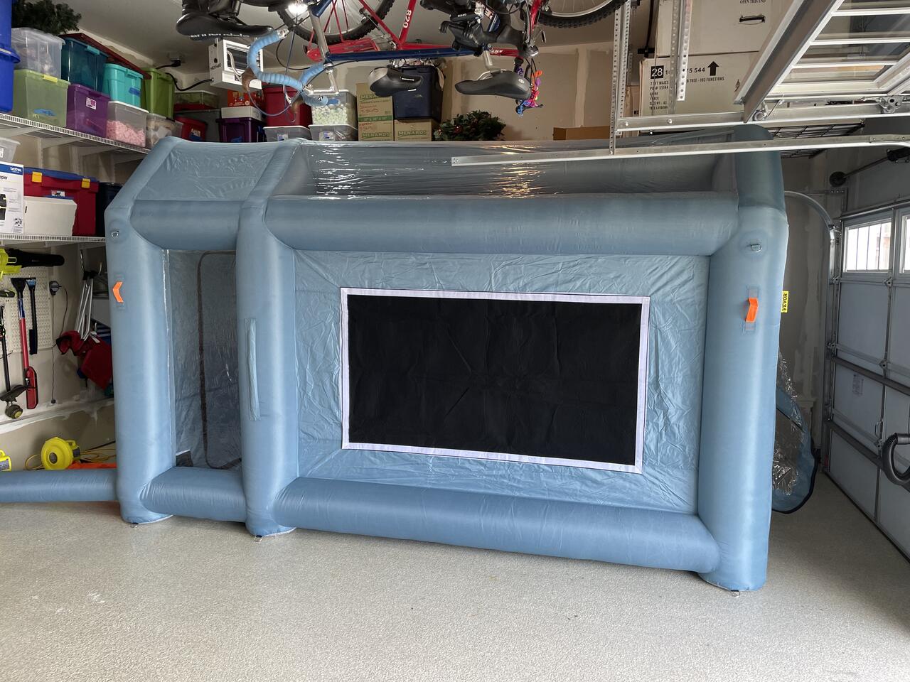

    I bought an inflatable finishing room from Amazon and with some PVC pipe and a few connectors, it will stand up on its own. Finishing outside is tough with the constant wind and the finicky weather in Minnesota.
    It fits nicely in the single stall of the garage. The overall footprint is 8.5' wide and and about 18 feet long with the blowers and supply tubes.

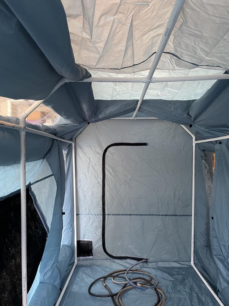

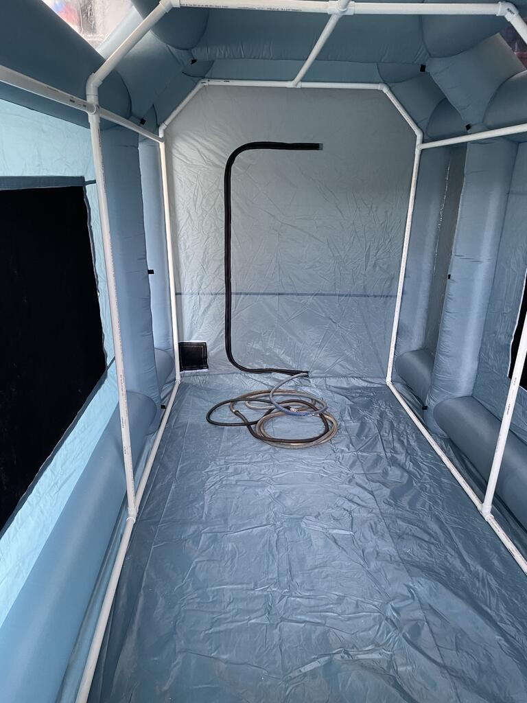

    Interior is roughly 7'x12' with 6' ceiling height at the eaves and 7.5' in the middle so plenty of headroom. I used 1" PVC to build the frame so I can turn off the blowers when it isn't in use without having it collapse on anything drying in it.
    It came with two blowers, one for inflation and the second pushes air in through the carbon filter on the lower left of the door in the picture above. The large windows on the sides are also carbon filters to allow air to exhaust and to catch overspray. The hose on the floor is the air supply from my Fuji HVLP turbine.
    This last picture is with the blowers turned off and the finishing room collapsed.

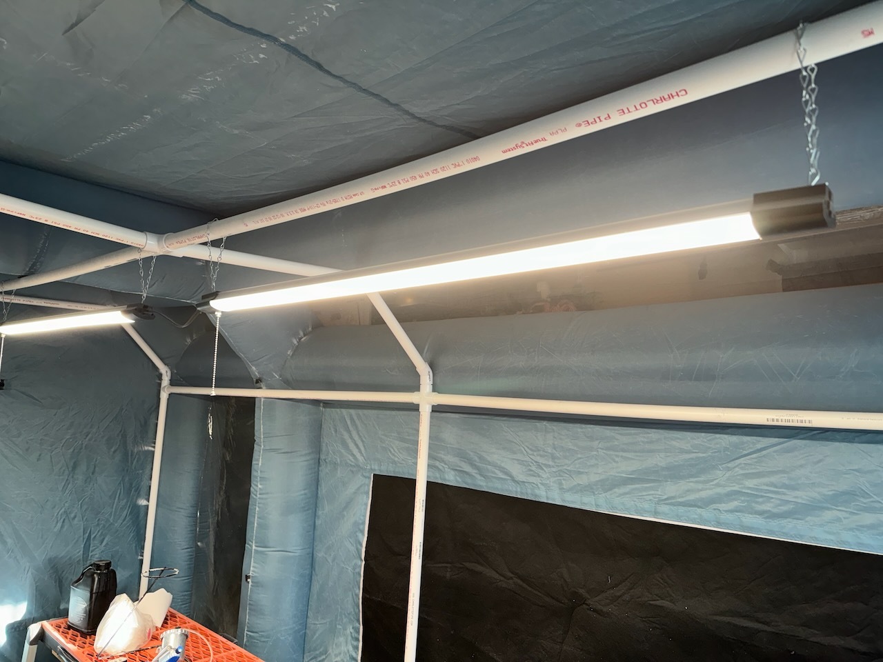

          I picked up some 4' LED lights at Menards and solved my lighting problem in the spray booth. I started with one, and added a second a couple of days later because I was still getting shadows.
          Added Lighting in the inflatable finishing room
