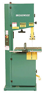

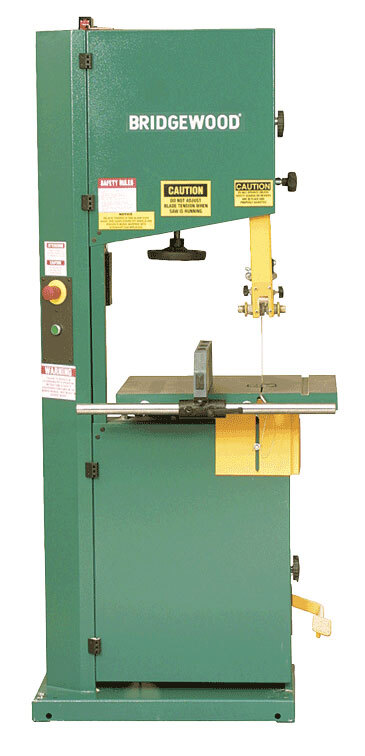

                You have what I call a Eurostyle or SHeetmetal saw which has a boxy welded frame. As opposed to the cheaper but solid construction I call cast iron saws with a cast iron frame and rounded covers over the top and bottom wheels.
                Eurostyle sheet metal saw
                Click image for larger version  Name:	band-1_600x600.jpg Views:	0 Size:	44.2 KB ID:	850484

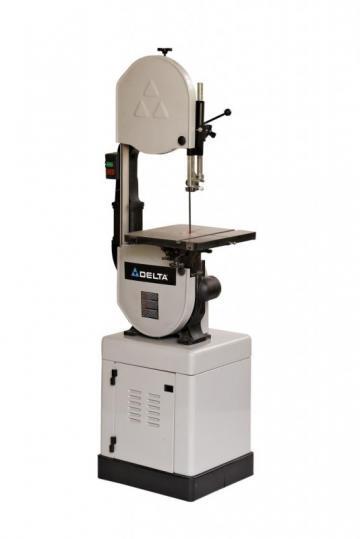

                Cast iron Delta style saw with riser.
                Click image for larger version  Name:	Delta cast iron bandsaw with riser 14 inch.jpg Views:	0 Size:	10.5 KB ID:	850485
                Usually the Eurostyle are fixed - no riser; the cast iron has a flange in the vertical neck that can be extended with a riser to increase vertical capacity by 4 inches or so but forces you to change the length (i.e. buy a whole new set) of your blades to 8" longer. It does not look like your saw as a riser, those kind generally don't but do have a larger vertical cutting height out of the box. As Hank says you are maybe thinking of the adjustable upper blade guide height adjustment.
                Your Bridgewood looks very nice and I am envious. Both in condition and by name reputation

                    This is the Bridgewood 440 PBS saw... someone told me I should drool over it.
