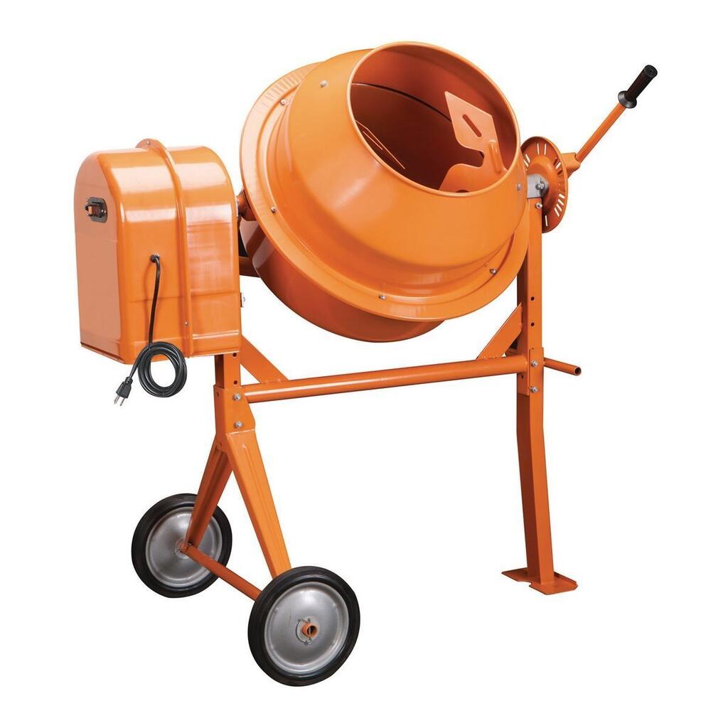

            I used one of these concrete mixers for 10 years, paid less than a week's rental would have cost me and sold it for nearly what I paid for it. The price hasn't changed since I bought mine, but I did have a 20% coupon.
              capncarl commented
              Leehlip, This thing will work you to death! A yard of concrete takes 7.7 loads from this mixer, and 72 bags (50 lb) of sacrite.
              leehljp commented
              I remember as a kid watching them load and mix and pour continuously for a whole day and a half. It wasn't work for me to watch! :-)
              capncarl commented
              When you were a wee tot hard work was not that hard
