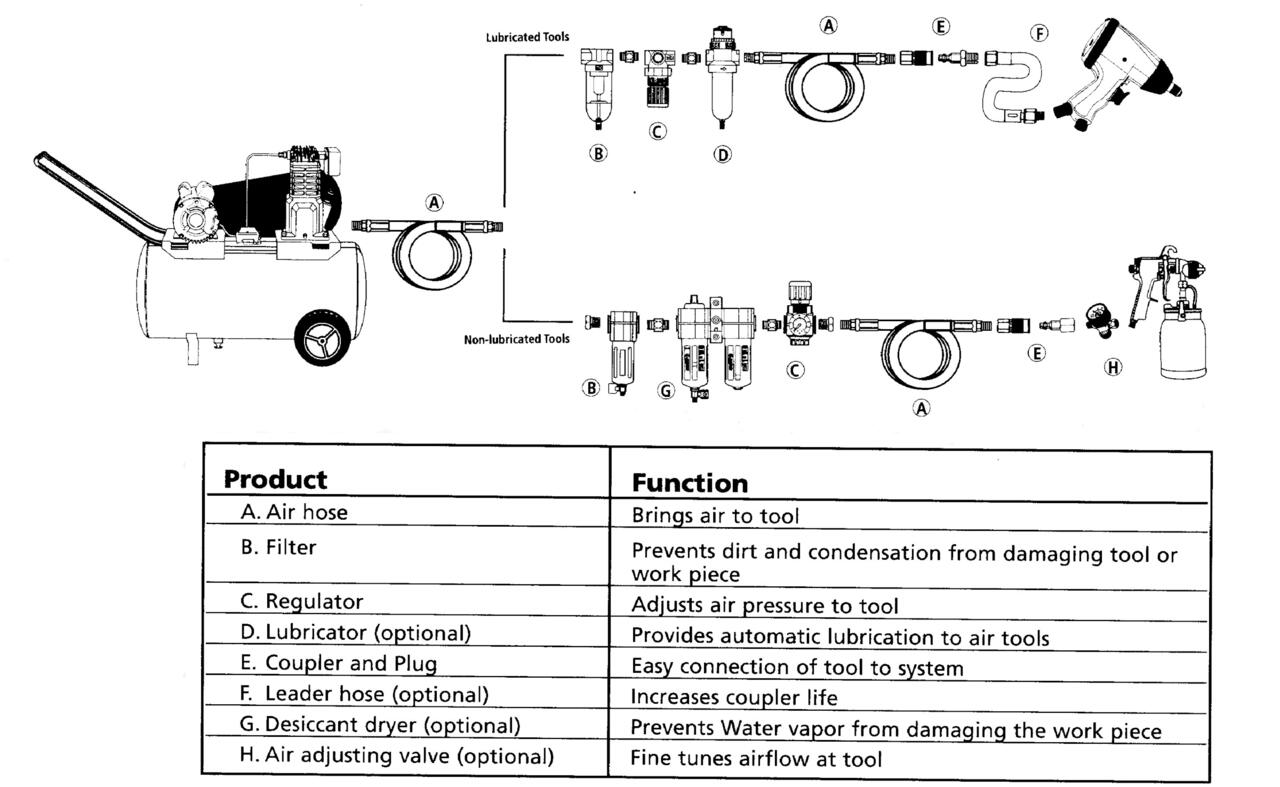

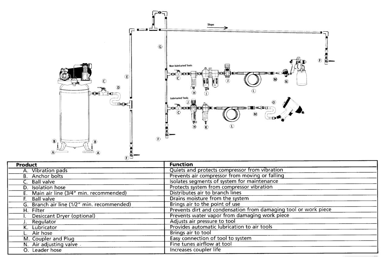

    Here is pictorial diagram of a typical compressor installation set-up for piping. I was hoping I could just give you a link to the mfg site, but I couldn't find the diagrams there. Take note that when installing air line of any kind, you must design in proper slope to ensure that moisture cannot drip back into the compressor discharge or into the tools being fed. "Drain legs are placed at points in the piping system to trap any moisture, oil, etc, that might otherwise damage the compressor or tools. These so-called legs, are fitted with valves to allow manual drainage of the air system piping.
    On industrial systems drain valves are often automatic. I notice that someone mentioned using galvenized pipe; in industrial practice, galvenized pipe is never used as the zinc will flake off in time and damage the air tool.
    Hope this helps,

    Interesting. I need to dig up my HF manuals. When I set up, the layout was recommended as follows...
    Compressor --> Air regulator / filter --> Oil sepataor / dessicant dryer --> line out to hose. And yes, IF in the case of my dual input, there is a straight up shot from the compressor to the filter instead of sideways with a slope, use a one way check valve, which I do... I see a LOT of setups factory pre configured with the regulator / primary filter at front and dessicant dryer at back, and yet other designs the other way around...
    Each drop yes gets a dump valve at the bottom to bleed off any potential condesate.
