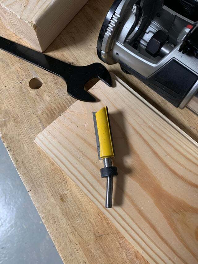

    This is why - didn't happen to me but I saw pictures on the web.
    Click image for larger version  Name:	bent router bit.jpg Views:	0 Size:	70.0 KB ID:	848324
    1/2" shanks are not twice as strong as 1/4" but at least four times stronger because the cross section area is four times more. And the added diameter also resists bending moment.
