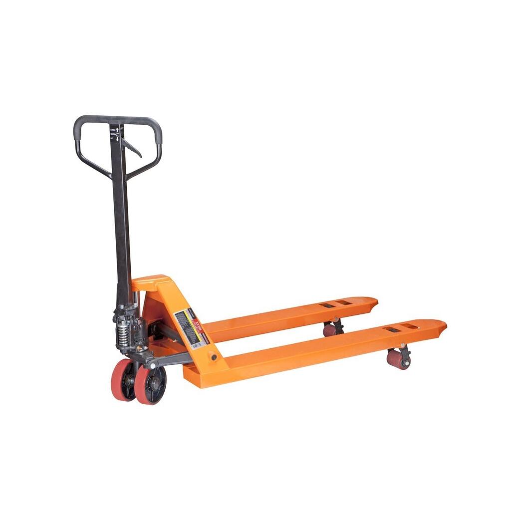

              make your new lathe cabinet with an open bottom and move it around with a pallet jack. All of your future cabinets could have the same feature, then you never have to worry about sorry caster wheels. Some pallet jacks are smaller than a standard pallet so it doesn’t have to fill up the shop.

                Originally posted by capncarl

                pallet jack a good idea except that then you have to have some place to store it when not in use.
                Can also be hard to maneuver in close quarters.
                  • 3791
                  You don’t have to store it elsewhere, just leave it parked under the lathe in “it’s” cabinet. Notch out the cabinets where the handle is incorporated in it.
                  they also make smaller and narrow pallet jacks.
