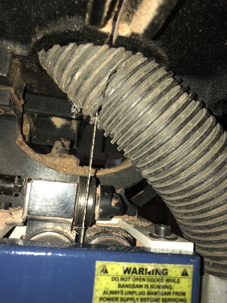

    Just throwing vacuum into the lower guard doesn’t accomplish much dust collection when the blade guides set above it with no dust collection on it. The lower blade guide are is cramped and hard to get any fittings around it. I tested a piece of 2.5” vacuum cleaner hose attached into the bottom under the removable zero clearance to see what effect it would have. It picked up a remarkable amount of dust, but was difficult to make a fitting for this location. Currently I a have a 2” “ell” fitting wedged under the zero clearance plate for a lack of having a better idea. It does not need a lot of vacuum, as in a 4” hose, to do a good job. Design a proper fitting for this application and you could probably start a successful business making and selling them!

        If properly constructed this connection should only be pulling air from the cut in the fitting ( or hose in my photo ) for the saw blade and the vent holes and saw blade cut in the zero clearance plate. A 1” vacuum cleaner hose should provide that much,

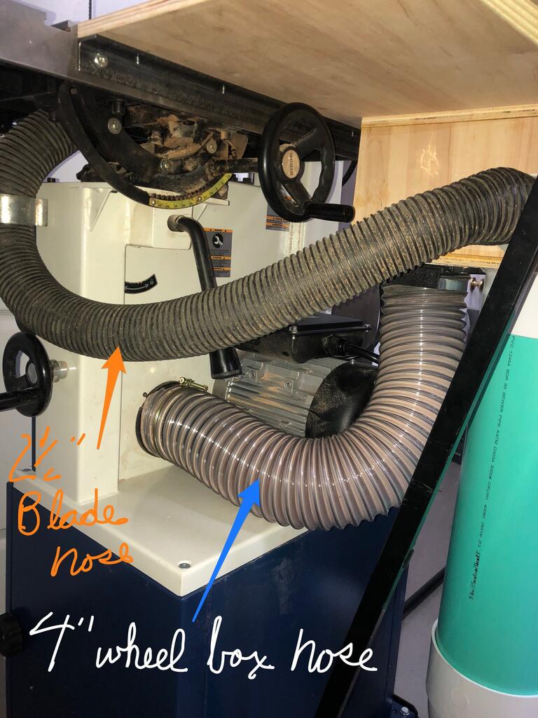

      My Rikon band saw has a 4” collection port in the bottom of the lower wheel box directly under the blade. It keeps the dust buildup to nearly nothing around the wheel. I have since put a blast gate and throttled it down a lot.
      I believe that dust control needs to be built into the equipment by the Mfg, and this has not been the case in the old Delta saws and their copycats, and the less expensive saws. There is certainly a lot of room for improvement in this department.
