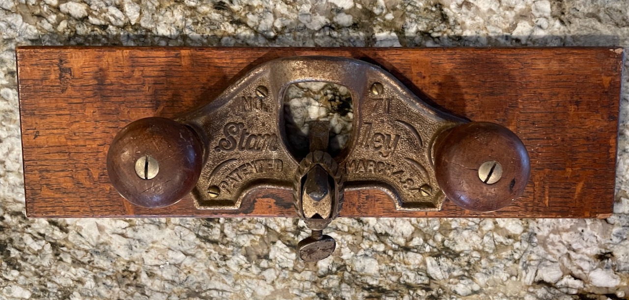

                Originally posted by Jim Frye
                Didn't Stanley make that tool a hundred plus years ago without the motor? Sorry, couldn't resist.
                Draw the edges, cut it with a back saw and hog out the dado with this. It's effective, but setting up the router is easier.

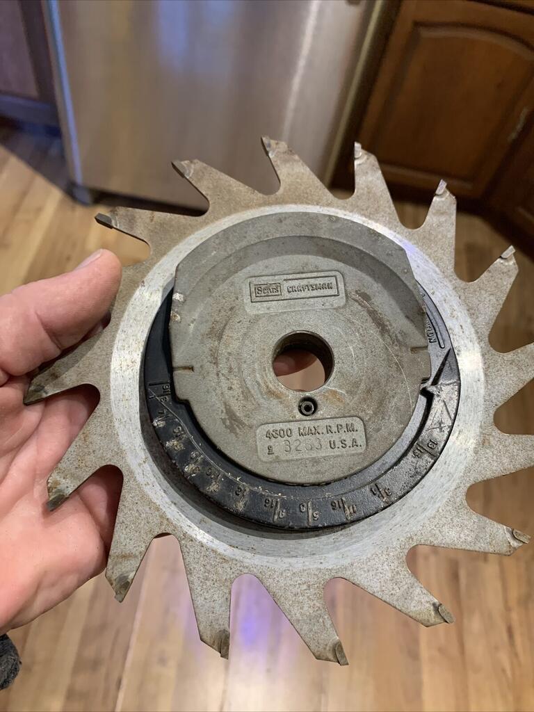

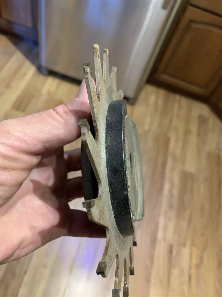

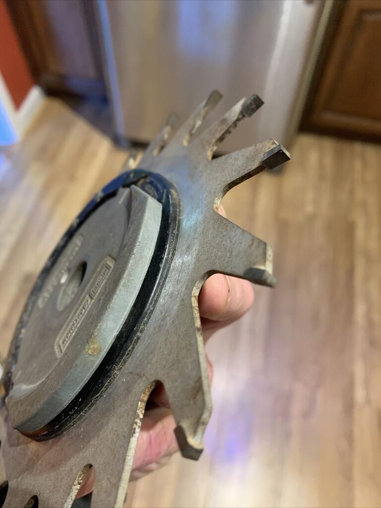

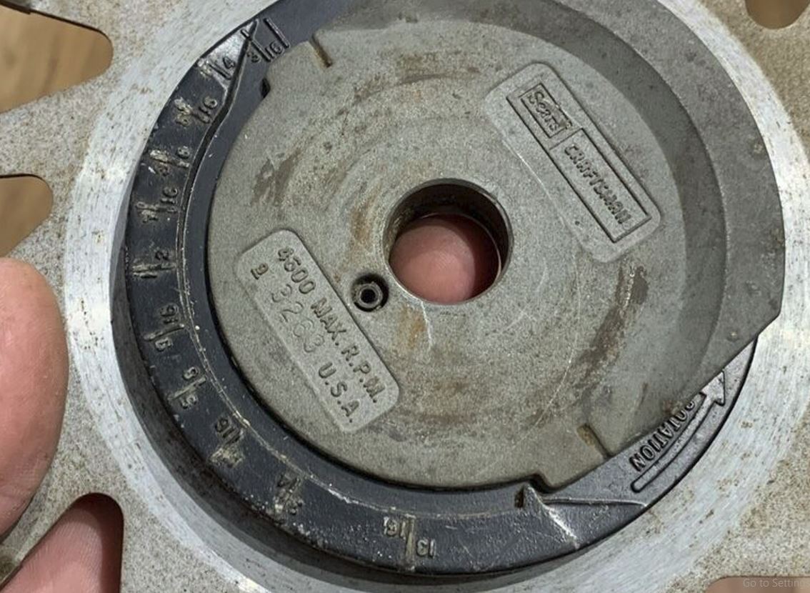

                          If you use a wobble type dado the mass won't be too great as there is only one blade, but the hub will be more massive but closer to the center so less moment of inertia. a restricted wobble width would reduce that mass somewhat. The one pictured goes up to 13/16" On the pictured Sears dado the amount of adjustment for 1/2" is just 1/3 the adjustment for the maximum 13/16"
                          The thing is that a longer arbor is needed for a hub that has an adjustable tilt.
                          And with a 7-1/4" blade the curve at the bottom will have a 3-5/8" radius to it. But no worse than wobble dados for table saws which are 7" by and large.
                          However the mechanics of it will result in perfectly vertical walls.
                          Some pictures of a 7" Craftsman wobble dado blade for sale on eBay
