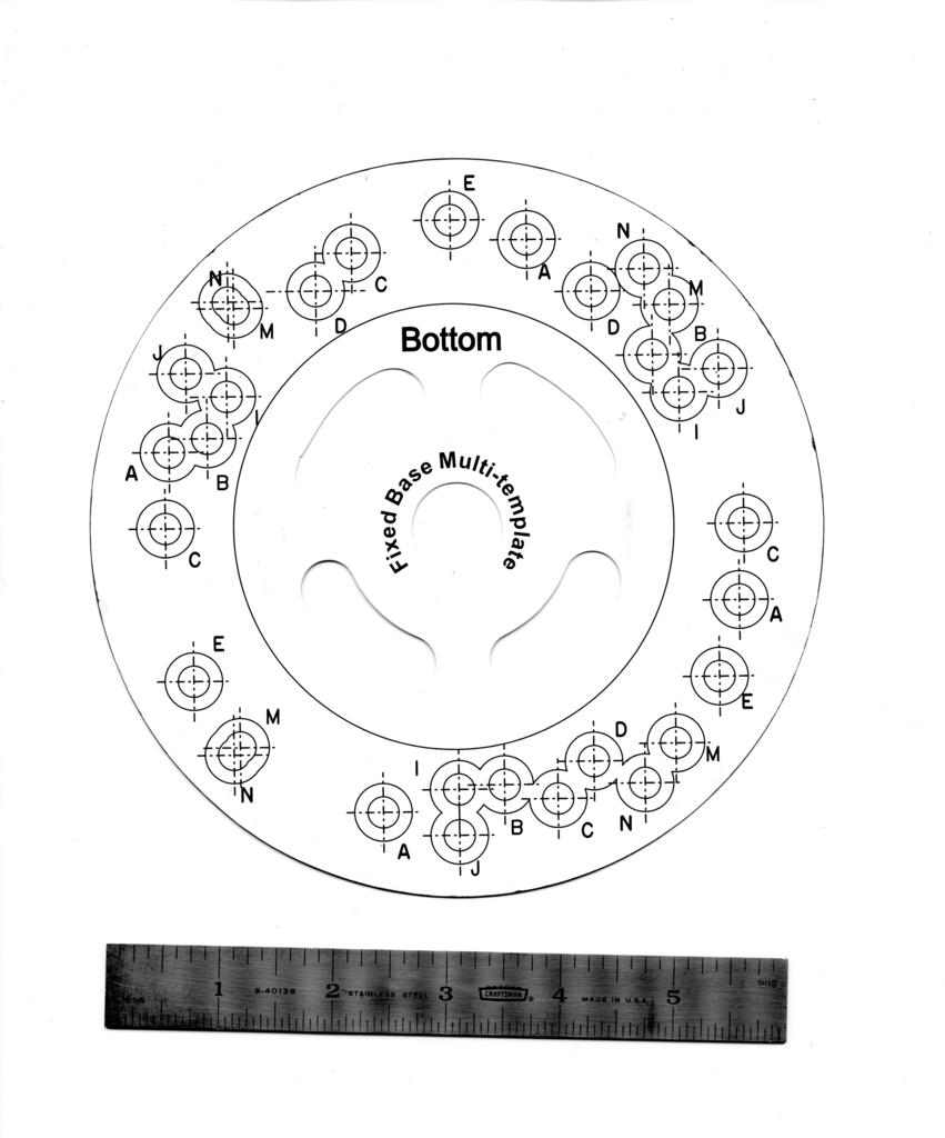

    Hello,
    I have picked up a used Ryobi R165 (1 3/4 HP) router. The router is in good working condition. Unfortunately, it is missing the base plate.
    So I am trying to find a way to trace the mounting hole patterns to mount it to a table. My search on the internet hasn't been successful.
    I am wondering if anyone has this router and can send me a dimensional drawing showing the mounting hole positions.
    Another option - since the BT3K accessory kit had a router mounting plate and both are made by Ryobi I wonder if the hole pattern might match the R165. So if someone with a plate can send me dimensions from that plate that is fine too.
    Thanks in advance.

                    • 2812
                    I'm a bit late here, but hopefully this might help. I had a Ryobi router table that came with a router, but I don't remember the model number. I believe it was an R161 or R165. I just gave that away a few months ago. Looking through my accessory draw this evening, I found a couple of templates, one marked 'fix base' and the other "plunge base'. I think they came with some optional baseplates that I purchased years ago from Ridgid or Ryobi.
                    In any case, they may be worthless but I thought I'd scan one in and provide it too you just in case it is helpful. Make sure you set your printer for 100%, no reduction! Do not select the "fit to page" option. I included a six-inch scale in the scan. The template diameter measures 6-7/16". I've attached both the PDF file and the JPEG. I printed both on my laser printer at 100% and the match the original template.
                    Hope this is helpful,
Name:	Router base template.jpg
                    Router base template.pdf
                    • nicer20
                      nicer20 commented
                      That's great. I will print this asap and check. Thanks again for providing. Will let you know how it goes.
