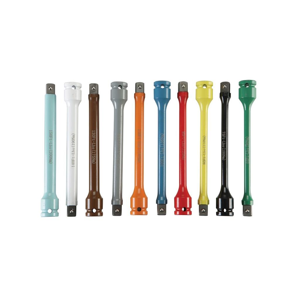

    3. I found these at HF: Torque Limiting Extension Bar Set, 10 Pc.
    https://www.harborfreight.com/12-in-...-pc-69870.html
    Anyone use these?

      Well, I rotated the tires. The light weight impact wrench did not budge the lug nuts for loosening on the front, but did on the rear. The front were so tight that I had to use a 2 ft breaker bar over the 4 way wrench and I was afraid that I was going to twist the bolts off. I felt like I was loosing an 18 wheeler wheel.
      I ran by HF and picked up the torque limiting torsion bar set after reading reviews on HF and on Amazon. I don't understand how they work exactly but I tried the 80 ft-lb set all the way around.

        How do the torque limiting extensions work. Do they just get soft and spongy if you try and push them too far?
        Doesn't look like they slip or click. Looks like they have precision machined thickness which has a lot of give at the torque limiting point.
        oh, I got it. It works when you use it with an impact wrench. At some point (the rated torque) the impact loads it up and releases it before the opposite end rotates any, thus limiting it to the amount where the torque stick yields the amount of the impact stroke.
        Costs $60.

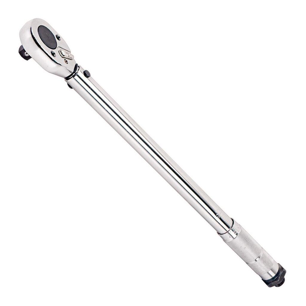

        Isn't a HF torque wrench at $20 a lot cheaper than a set of these?
