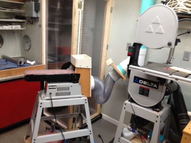

    My first stationary belt sander was a no name brand 4x36 unit. It did the job well, created uncontrollable bust plumes any vibrated like crazy. The disk sander was almost useless. I put it in storage when I replaced it with a Delta 6x48 stationary sander. There was day and night difference in the sanding capabilities of the slightly larger unit. There was very little difference in the build quality in the 2 sanders, the Delta also vibrated badly and created lots more dust! The disk sander was slightly more useful, but I believe that the disk sanders on a stationary belt sanders are an afterthought. The larger belt sander belts lasts many times longer before they wear out and don’t have a tendency to curl up on the edges like the 4” belt did. That makes a difference when flattening stock. I found the vibration was caused by the Sanding disk and remove it, Runs like a sewing machine now. The dust problem was solved by building a collection box on the back roller and hosing it directly to my dust collector.

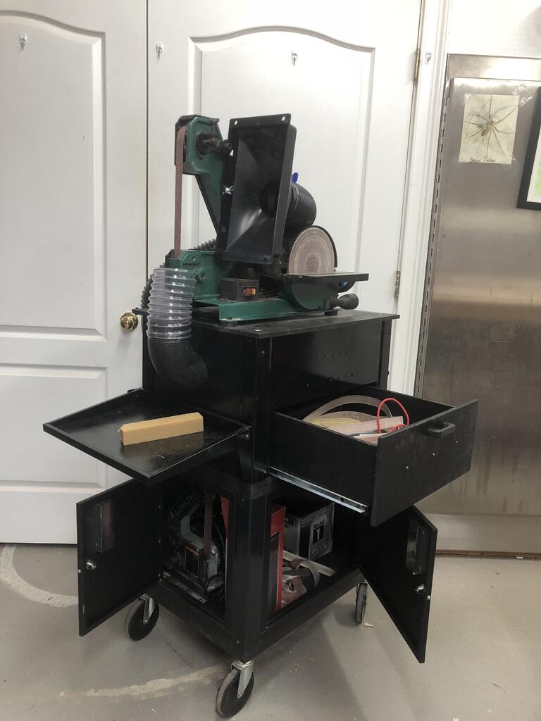

                I had the HF, very much junky. I currently have a huge Jet edge sander, very good, but really, too much. It will go away. I also have the Ridgid belt and spindle sander, which is surprisingly good. I find the spindle useful, maybe more than the belt. I'm also finding that I need the belt MUCH less as my tools got better, more precise, and my skills improved. Now there's so much less to sand.
                I have no idea if this thing is still available, I stole it for $50 on CL.

                    Notice the flip table that mine is on. That would help with your space issue. The flip side is the planer. I never need the planer and sander at the same time.
