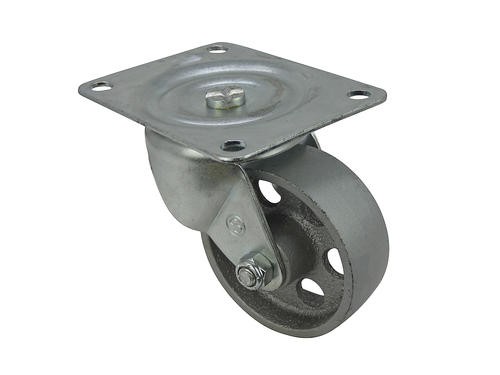

    If you want true longevity that can carry heavy loads, I have an antique safe with 3" iron wheels that are over 100 years old. The safe weights about 400 lbs. Iron/steel and aluminum roll nicely on a clean floor but since they won't deflect at all, a pebble will bring it to an abrupt stop. They're also noisy and will dent any floor other than concrete.
    Menards has the 3" iron casters shown below for 6.50 each.

      That's interesting - iron casters should definitely live up to 'longevity'! But yeah, the 'no deflection' could become an issue.

            I'd be concerned that with a steel or iron wheel, they just might rust so bad you wouldn't be able to roll them, unless of course they were designed for a moist environment.

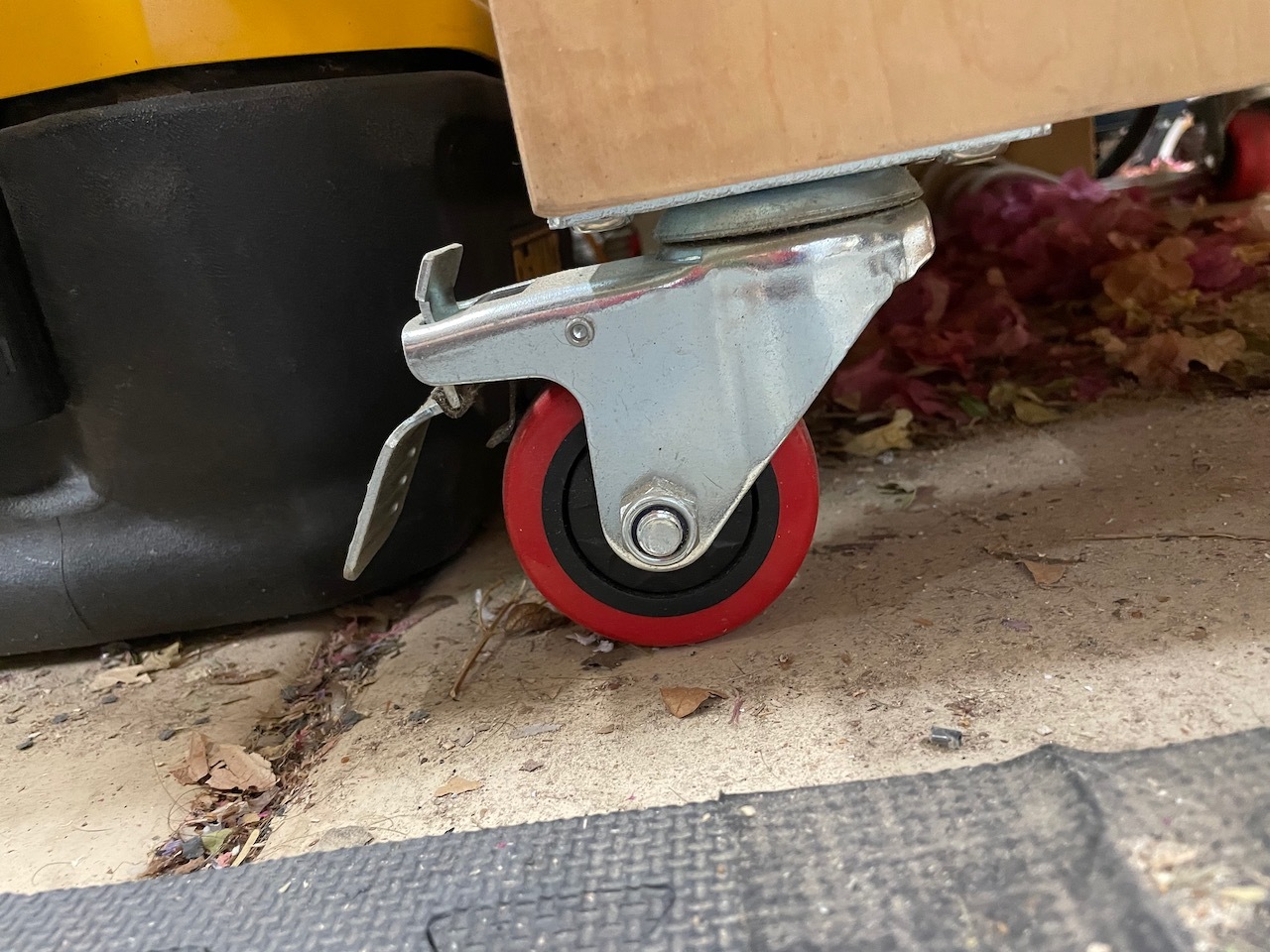

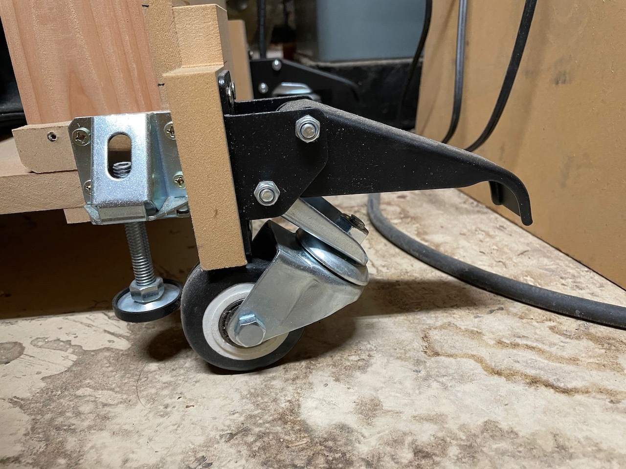

                  Just bought 8 - 3" casters red plastic/poly on amazon made in China it was cheap ($31.99) hope they last. I also bought 4 Power Tech work bench casters 2" diameter wheels little more expensive ($51.99) on Amazon again made in China, hope they last. Both had good reviews. My 3" Wood Craft red wheels, they weren't cheap all disintegrated after 3 Yrs. Lots of moisture & humidity in Hawaii. So decided to buy cheaper wheels and if need be change them more often.

                    Ok, yeah, that's definitely one way to go - planned obsolescence instead of worrying too much about longevity.
                    I definitely don't want to spend too much on castors. I'll probably go with moderation - decent reviews, not too expensive and keep an eye on them for replacing.

                        I really don't move anything around in the shop, but did put a few things on wheels in case they need to be moved for large lumber or similar space/access reasons. These have only been in use for a few years, but seem to be fine so far. I move these less than once every six months. The red ones are from Lowes, the lift/move ones are from Amazon. The lift casters are especially great. I have those on a bench extension that's used as outfeed, assembly, and mobile cabinet when needed. As well as moving it if needed. They lift up to move easily and make it over the mats, but drop down onto the hard feet for stability and perfect leveling. Since it's outfeed, it has to be perfectly leveled. Floor dots tell me where exactly to put it back.
