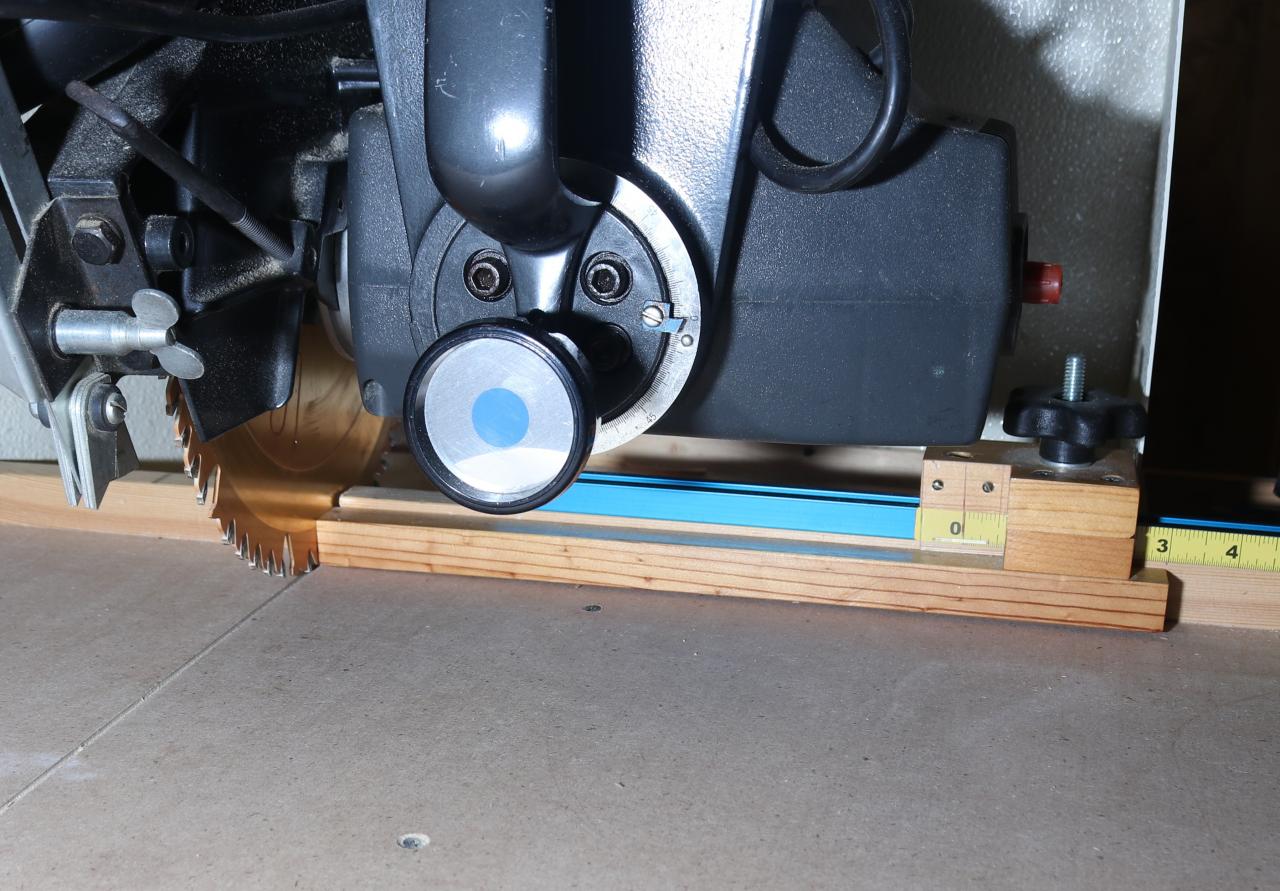

      On my RAS, I have a steel tape across the outfeed of my fence and use a home-made measuring stop (picture below). With that I can cut any number of pieces to length with relative precision. Using a measuring tape they all come out the same length that I've set on my indicator. However, time effects the moisture content and therefore the length of my 'stop' and I have to change it every so often. Before doing the cut, I just run the stop up to the blade and check the indicator on the fence measure, if it's '0' then I'm good, if it's less, then it's time to cut a new stop, screw it in place, adjust the mark to '0' and then cut the stop to length.
      To that point, 'precision' in wood is sort of illusive, at least when it comes to measuring in thousands. It expands and contracts too much.

      For something like the angle indicator, I think if you want absolute precision you'd have to check that thickness every few months as the season changes; however, how much change to the angle setting would occur if that small block shrank or swelled by a 64th of an inch? Probably not enough to care about, and if it did, then make the block out of some material that temperature or moisture wouldn't effect.
