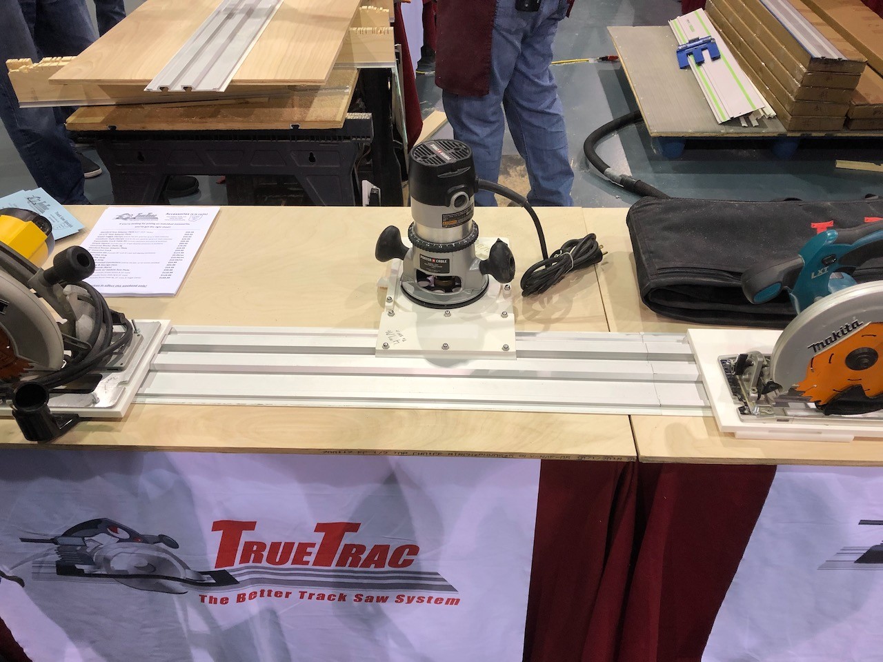

                Do you think this system would work as well as the Grizzly? https://www.truetracsaw.com/

                    Disclaimer I haven't used this, but only saw them at the woodworking show in Milwaukee in 2019 and took the picture below. My notes on the photo were that the guide plates were sloppy on the track, lost alot of cut capacity to thickness of guide plate. Gap between guide plate and material being cut (no zero clearance without modification) track itself looks solid and locks together straight, overall unimpressed.
                    TrueTrac at woodorking show Milwaukee 2019
