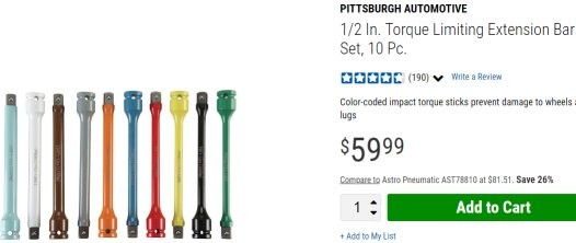

                      Way back when I used impact wrenches daily as a mechanic, I learned from others, and bitter experience, that extensions absorb the impacts and make the impact wrench or driver less effective. I have a 2 foot long 1/2" x 1/2" Snap-on extension that works OK for hard to reach apps, and I also have a 2' long Snap-on extension that is half inch at the drive end, and 3/8" at the tool end. The thing is thinner along it's length and doesn't work in the same application using the same 3/8" socket with an adapter on the 1/2"x 1/2" extension. The thinner extension is also less effective when using it with a hand ratchet. I bought the thing initially to use with my Snap-on 3/8" u-joint spark plug socket because the combination of the 2' 1/2" x 1/2" an adapter, and the socket were hard to keep together. Using the new 3 piece set-up vs. the old 4 piece setup worked poorly. I had always used a short 12" ratchet with the arrangement, but found that with the thinner extension, I would really have to muscle it to remove spark plugs, and when it released, the back lash would snap and reverse the ratchet pawl setting. The end result is I have several 1/2" x 3/8" barely used extensions in different lengths. Sure are pretty, though.
                      Just saw these, for the first time:

                        That's all accurate. However, the results and effect on a huge impact with long extensions on large fasteners is very different from what you get with these small drivers and a 2-3" bit on small fasteners into wood. Both the documentation and my experience tells me that the change it makes is totally positive. I've completely switched.
