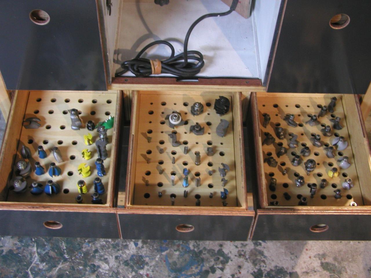

        I built this back in 2002 when I was in Japan; I left the router table there and built me another one recently and used the same design for the drawers. I now have 4 drawers full of router bits. If I were to rebuild (which I do NOT plan on doing, I would use the foam rubber matts above. I could drill holes but it sure is nice not having to drill so many holes. PLUS, 1/2 in is not large enough. You need either 33/64 or 17/32. The first set I did 1/2 inch and then sanded the holes. Humidiy gets into the wood and will leave rust marks on the shanks. Look for an purchase a good 17/32" bit for 1/2 inch bits and a 9/32" bit for the 1/4 inch shanks. Too much space and they will wobble around.

          Yeah, I have bought 33/64 and 17/32 bits for just the purpose Hank suggests, they make perfect slip fit holders for 1/2" shank router bits. You'll have a 17/64ths in your normal bit sets with 1/64th inch-increments .
          I just like it when there's a slip fit with no play... it's very functional that way too, Just a hint of friction as you pull them out.Won't fall out.

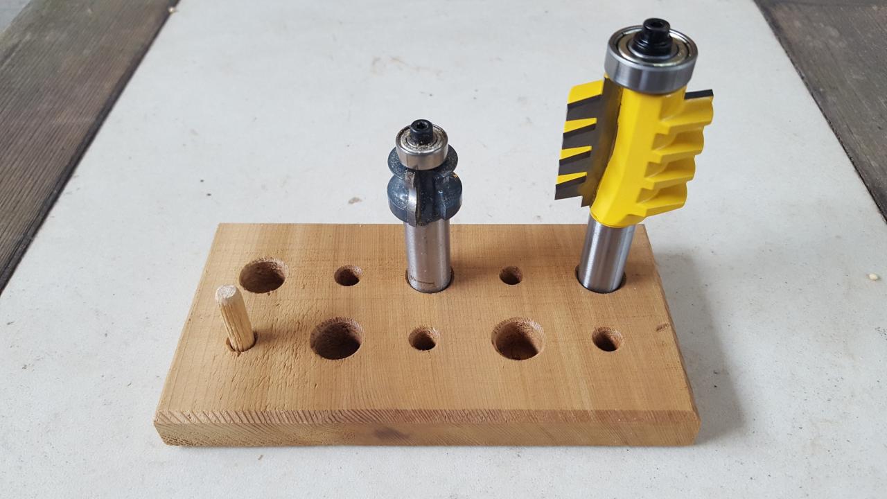

          I have a little 3 x 5.5" parking lot for bits, 10 holes alternating 1/4 and 1/2 holes when I'm doing a lot of bit swapping and to put the chamfer bit I normally leave in the router table. Holds several bits but easy to move out of the way.And keeps the bits from getting knocked about and chipping the carbides.

            Here's my Router bit parking lot. Stays in the vicinity of the router table to temporarily place bits without worrying about them rolling off the table or scratching of damaging stuff that gets set on them, or hitting the carbide edges. Four felt or rubber pads on the bottom.
            Click image for larger version  Name:	Router bit parking resized.jpg Views:	0 Size:	91.3 KB ID:	840322

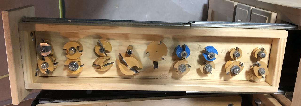

              I just used pine boards with 1/2 or 1/4 holes drilled in them cut to fit snugly in the drawers of my router table. There are spacers on the bottom of the boards to raise them up from the drawer bottom so the shanks are able to go in a bit deeper.
              Router Bit Storage in Drawer
              Router Bit storage tray
