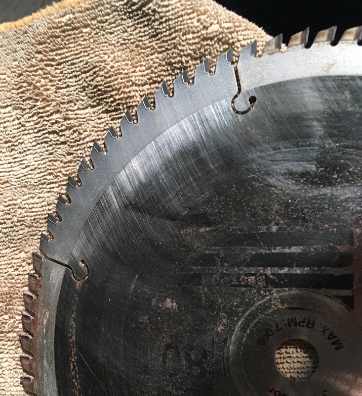

    I sprayed each agent on a different part of the blade and scrubbed lightly with a marron Scotch Brite pad.
    1. Goo Gone was a bust. Didn't have much affect on the residue and left a mess on the blade.
    2. Zep Foaming Wall Cleaner worked but took a fair amount of effort and scrubbing.
    3. Zep Mold Stain and Mildew Stain Remover. I had highest hopes for this since it was similar to what I had used in the past. I wasn't disappointed and I think it would work better if the blade soaked in the solution but I didn't have a container big enough for this.
    4. Mr Clean Clean Freak is fairly new to the market and works well as a household cleaner. Surprisingly it out performed the stain remover and seemed to start dissolving the residue in a matter of minutes. The 'scrubbing' took very little effort.
Name:	Blade cleaning result.jpg
    Next test will be to get a container to soak the blades in and clean 2 similar blades with the stain remover and the Clean Freak. I will try to clean them with just a tooth brush and report the results.
