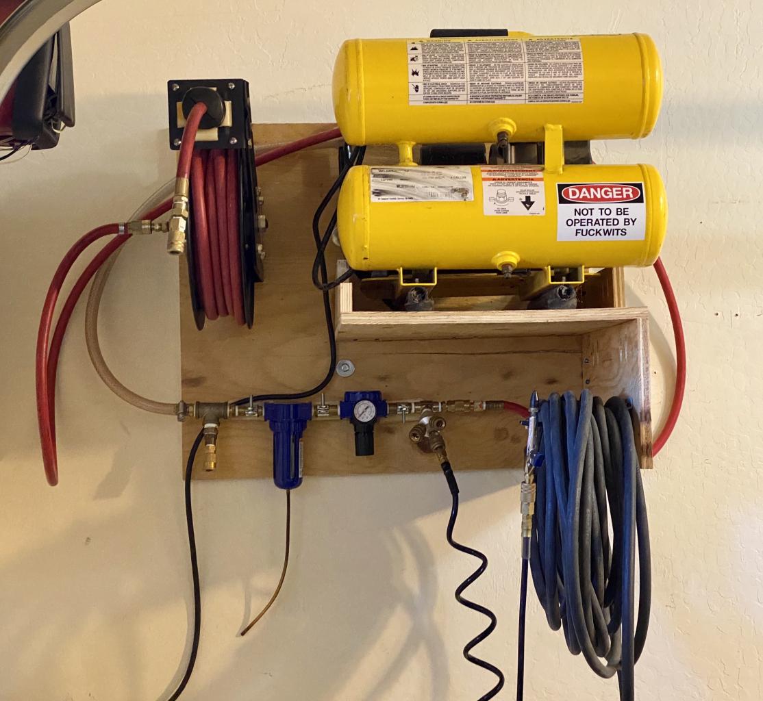

        It's like 3M thought of everything. There's a flow control valve and regulator included with the gun. You will adjust the flow to 20 PSI *with the gun fully open* which is the key. Input pressure is irrelevant (I couldn't find any max, and minimum is 24 PSI). I leave my compressor at 90 at all times. I added a 6' Flexzilla whip permanently attached to the gun, and then a regular air connector at the end of that. The Flexzilla hose is super soft plus has a swivel fitting at the end near the gun. Perfect for shooting in all directions, since this gun can do it.
        https://smile.amazon.com/gp/product/...?ie=UTF8&psc=1 (Note you also need a female to female thread coupler to attach this)
        I also built a cart for my spraying needs, I should post some pics and thoughts.
        I used all the normal types of lines and couplers, and it certainly flows enough. However I tried adding an inline air drier with a high CFM rating, and it's obviously a false rating. It's unusable and drops the flow so the pressure is well under 20 in use. My full rig is:
        CH Contractor Extreme 4 gallon compressor
        4' 1/2" hose to wall mounted shutoff valve
        Wall mounted drier/filter, regulator, and multiple couplers
        Harbor Freight 3/8" hose reel
        Standard coupler
        Flexzilla whip
        Regulator/flow control
        Gun
        I continue to be super happy that I made this change. I also picked up the big kit of "midi" cups, as well as "starter kits" of ten cups each on all the other sizes. So far I've used a maxi cup for primer, two midis for paint, a mini for lacquer, and a micro for some crazy expensive tri-coat pearl auto paint. The micro let me use just 1.5 ounces of this expensive paint effectively. (Lamborghini Balloon White Pearl.)
        I also sprayed some under-thinned latex just to see what would happen, using the 2.0 nozzle. It was EXCELLENT! Great coverage in a single coat. From now on I will thin less than normal, and just use the huge nozzle for latex. Lacquer was shot with a 1.4 thinned as normally recommended, and the automotive base with the 1.3 and recommended reducer volume.
        I've taught two young boys how to spray now (10, 13). Both picked up the gun and were reasonably good, for kids, in just minutes.​​​​​​​
