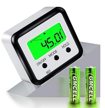

Bought a new angle indicator.
    https://www.amazon.com/dp/B07R12DZQ9...roduct_details
    Was only $16+ something.
    I have had a Wixey for tens of years but it has gotten intermittent and just frustrated the heck out of me. Not the battery or the battery contacts, it just sometimes jumps 20 degrees. It ate Batteries even when off but The back was always so hard to open to take it out when not in use.
    The new one is half the cost (even less if you consider inflation), and is lighted and takes AAA batteries instead of the lithium coin cell. More modes. Came in 2 days by Amazon Prime. It's about a quarter of an inch taller and wider and quite a bit lighter. but still has magnets. I think the 1/100th degree digit is totally unnecessary!
    No brand name, very generic.
    It's so nice to have tools that don't frustrate you to use.

    Is the little angle indicator in the top of the screen functional or just an advertisement?
      Its functional. For small angles it tells you which way its tilting, if you can't quite tell.
        For me, the way that they show the angle tilt is unintuitive to me. The bottom line should start at the other end to exactly reflect the actual angle from horizontal. I had to use a digital level a few weeks ago putting up about 150 studs in a building. I was assisting a carpenter who loved his digital level. It was totally counter intuitive to me every time. I had to quit looking at that and watch the old school bubble. I could never tell by the screen if I was a degree off to one side or the other. And I was far more accurate with the bubble.
        If that digital level would let me calibrate it from the direction and end, it would have worked much better.
        BTW, I think I would like the one in that is posted, as I have one that only shows up in tenths of a degree, which is not good enough for segmented bowls. I realize that it won't do miters but some segment cuts can be done with bevels, which the .01 would be GREAT.
          Don't overthink the angle indicator.
          There's a little up/down arrow to the right. Basically it points the direction you need to raise the right side to move it towards zero. When its perfectly level it shows a straight line and says "0".
          As for the .01 degree, it has what us measurement guys call resolution but no accuracy. In fact the accuracy spec says 0.1 degree.
          I set it on a pretty flat granite top, same place and it reads ,29 degrees, When I move it and set it repeatedly int he same spot I get valuse from ,25 to ,29. So the repeatability is only +/-.2 and I don't know what the actual is. The spec claims 0.1 degree, I assume that means +/- 0.1 degree I really don't have a more accurate reference to verify that over the whole range.

            Ahh! The little "up/down arrow". That is what I must have missed on the level. The carpenter just kept saying "if it is within .2 of vertical, that is OK." My problem was that at that level of accuracy, I could not tell which way the stud needed to lean or be tapped once it was within .5 or even 1 degree off without having to look at the bubble. I couldn't find a reference point on the digital level for which way to move it.

              I like using this kind of angle finder to set the angle of the blades on my table saw and sliding miter saw, no fighting with the teeth on the blade.

                      I have two of these, they are not used often, but so useful when they are. Like Carl, I like it for resetting the TS and SCMS back to zero. I've also used mine to do a front end alignment on the Jeep, as caster and cross-caster angle make a huge difference. I've never had battery issues with them, unlike the calipers which are constantly dead because they use power all the time. My HF welding mask must not use power most of the time either, as it gets a new battery less often than every five years (which makes me realize, I'm old, and it's over 20 years old).
