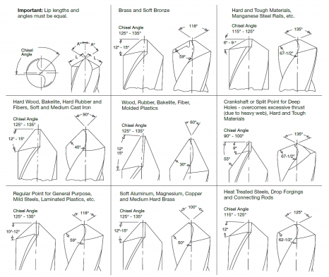

                        If drilling hard materials and you want to limit skating, use a 135° drill bit instead of the standard 118° drill twist bits most commonly sold.
                        The 135° has steeper angle and will skate less and is usually preferred for hardened steel and stainless steel.
                        I have a set of 135° drill bits for drilling harder metals.
                        THe down side is you can't sharpen them on the cheaper drill doctors which are meant for 118° bits.
                        The higher end drill doctors have a 135° setting.
                        Click image for larger version  Name:	Effienct%20Drilling.png?itok=5bZSPGoL.png Views:	0 Size:	151.9 KB ID:	837393

                          Thanks for that refresher. Your post made me do a bit of checking - I have two of the HF 115 piece Drill Bit sets: 1 Titanium coated and 1 Cobalt. I used the titanium set which is 118°; I should have used the cobalt set which is 135°.
                          It also made me think about grinding all of the the Ti set 1/8" and larger to 135°. I have the Drill Doctor 750 and it will grind to 135°.

                            it's going to take a lot of grinding to turn larger bits from 118 to 135. Hard on your abrasives,
                            The drill doctors are more intended for touchups rather than conversions or new pointing.
                            Why not just use the 135s for hard materials and the 118s for soft materials?
                              I was thinking that very thing. I did change a few bits a few year ago to 135 just to try it out. Worked fine, BUT not good for a whole set. I'll just use the cobalt 135 set in the future.
                              I think I did the change to 135 for drilling pen blanks where the entry point was critical. I just forgot that. Thanks for the suggestion.
