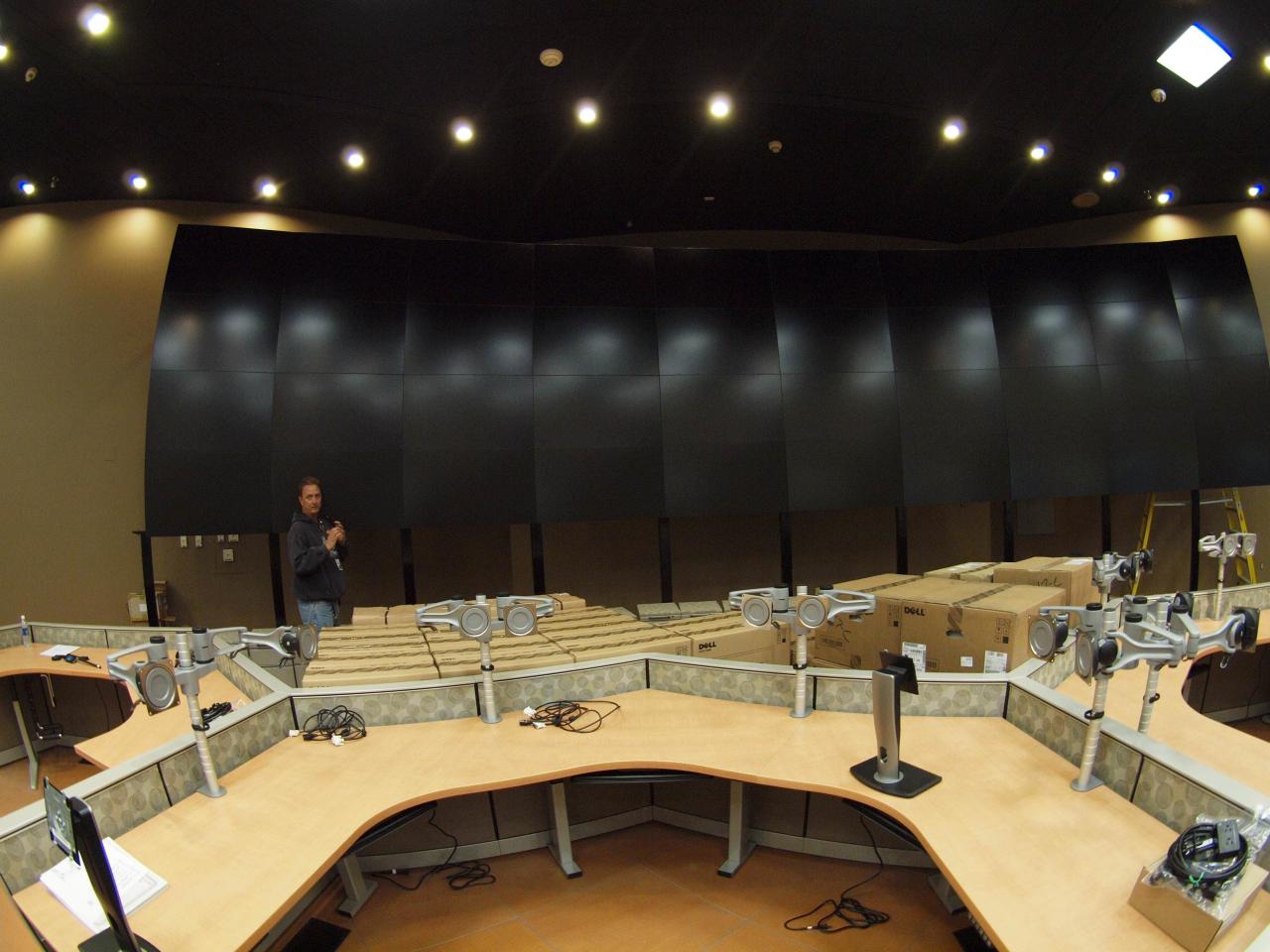

                What you've shown is that there is a huge variation in impact drivers. You'd have to pry mine from my cold dead fingers. My best friend has built some pretty amazing things in his job all with an impact, and he literally says "It has changed my life" so much that it became a running joke at his company. Both of us build everything with high-quality impact drivers and bits.
                This entire system was built with a few impact drivers and Tek screws, no drills, no hand drivers...
