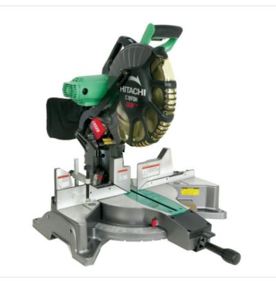

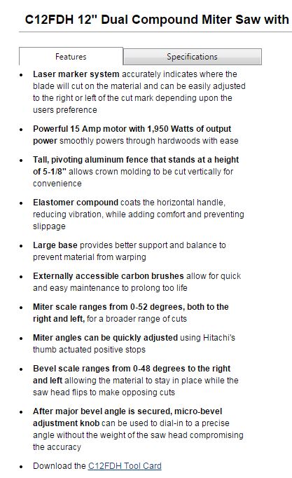

              I upgraded from a 10" CMS to a 12" dual bevel CMS by Hitachi. C12FDH
              I considered a slider at the time but the depth the tool required in the shop discouraged me from that.
              Pretty much the 12" CMS cut 99.9% of the boards I wanted to do, up from the 90% that the 10" did -
              the 10" would not cut 4x4s and 1x6's all the way through on 90 degree cuts.

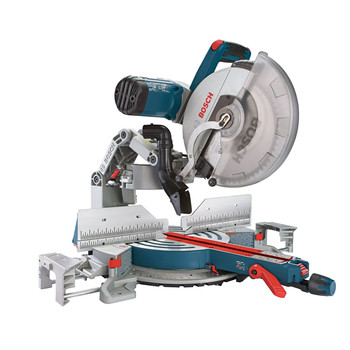

                    I have a 10" Bosch EZ Glide. will x-cut up to 12" They do also make a 12" version. I treated myself when I finished my new shop. The articulating arm is awesome. It really can go right up against a wall with just a little clearance to allow for turning when you cut miters. It is VERY solidly built, great in the shop but not the easiest if you want a jobsite saw as it weighs in a 65lbs. Unless of course you have The Rock handy to move it around for you!
